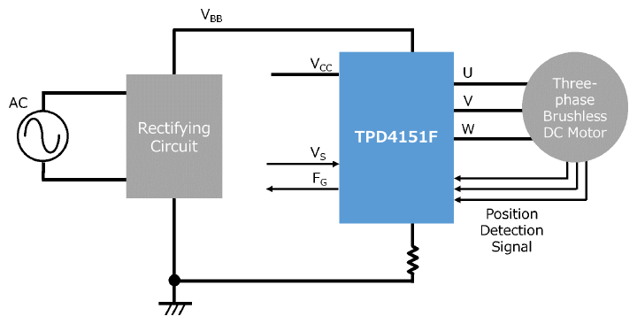

TPD4151F square wave control BLDC motor drive application circuit
• Description of brushless DC motor drive IC control method (square wave control type and sine wave control type)
• Brushless DC motor drive IC application circuit example using TPD4151F
• Design guideline for using both Hall sensor and Hall IC
• TPD4151F Because it has a built-in PWM circuit, three-phase distribution circuit, high-side/low-side gate driver IC, and output IGBT/FRD, it can directly drive a brushless DC motor without the need for a PWN control IC.
• Because it integrates 250V IGBT and FRD, it is suitable for AC100V power supply applications.
• Built-in overheat protection circuit and undervoltage protection circuit help simplify board design.
Blockdiagram
