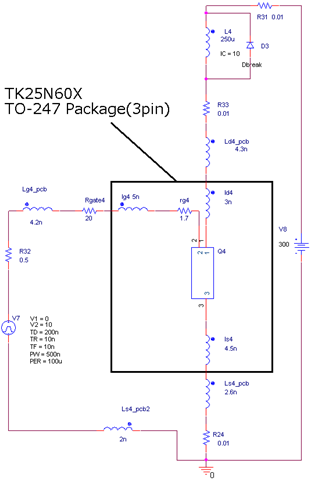

MOSFET 4 in-line package TO-247-4L (TK25Z60X) application circuit
• Introduced the features of the TO-247-4L package, a 4-pin structure, and a source terminal for the gate drive circuit compared to the traditional 3-pin in-line package.
• Introduced the characteristics of the 4-pin through-type package. Compared with the 3-pin package, it achieves smaller gate signal oscillation and lower switching loss because the 4-pin package is not subject to source wiring parasitics Effect of inductance.
