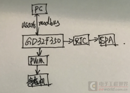

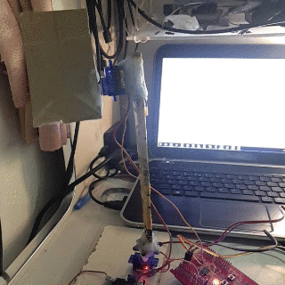

This design only implements the establishment of the basic framework, such as protocols, business processing, task processing, upper and lower computer interaction data, etc., and makes abstract interfaces one by one, and calculates the solar altitude angle and azimuth angle at this time through SPA. Simply use the obtained azimuth angle, altitude angle, etc. to convert the PWM duty cycle to control the corresponding rotation of the servo. There is actually a lot that needs to be done.
Blockdiagram
