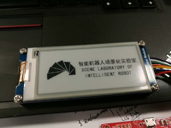

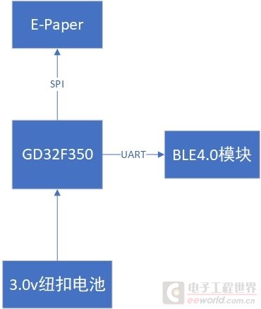

To sum up, the "portable information board" will use the currently popular low-power e-Paper ink screen as the information display end, and use the low-power, low-cost, high-performance GD32 as the main control, low-power BLE4.0 The Bluetooth module serves as a communication device.
Blockdiagram
