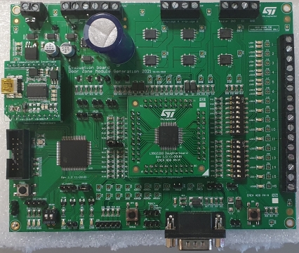

The EVAL-L99DZ200 evaluation board is designed for the Front drives Rear door zone architecture and for the power trunk applications.
[EVAL-L99DZ200 Photo]
The board is composed by a motherboard and a daughter board. The motherboard, which is based on the SPC582B60 microcontroller, provides the logic section for monitoring and driving the L99DZ200G device assembled on the daughter board.
With the aim of facilitating the use and configuration of the board, STMicroelectronics provides a dedicated user-friendly software with a graphic user interface (GUI). This GUI enables the user to set the L99DZ200G control parameters and at the same time shows real time diagnostics information as current output and battery voltage monitoring.
All features
Board functionality based on L99DZ200G, automotive front door device with LIN and CAN providing dual H-bridge driving
Mother Board size: 150 mm length x 120 mm width
Daughter Board size: 36.8 mm length x 35.6 mm width
Board reverse battery protection with STL64N4F7AG Power MOSFET
H-bridge with 4 x STL76N4F7AG Power MOSFETs
Heater and electro chrome with 2x STL19N3LLH6AG Power MOSFETs
FDTI for PC control via USB
All ST components are automotive-grade qualified
