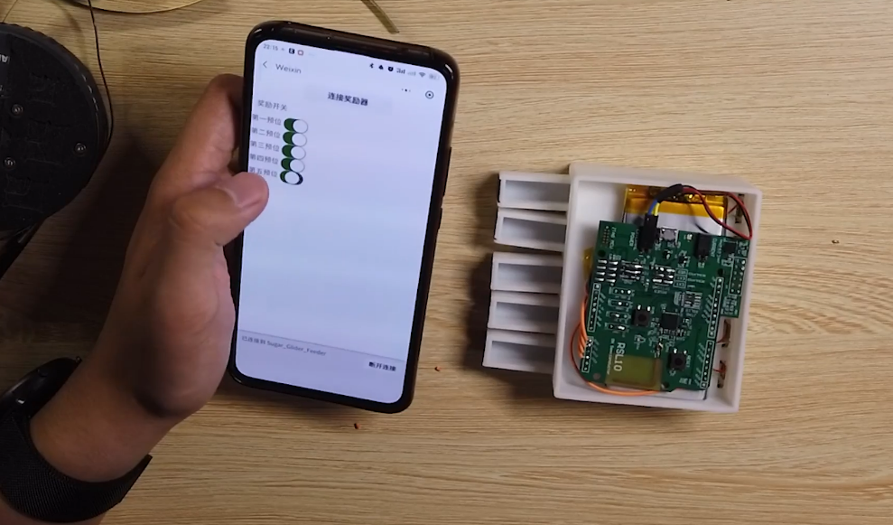

1. Sports health monitoring: Install the RSL10 sensor development kit on the Ferris wheel, collect light data through a light meter, collect temperature information through an air quality sensor, and monitor Xiaomi's movement on the Ferris wheel through an angular velocity meter. The running rotational speed data is recorded for one night and stored on the sensor board.
2. Sports and health data analysis: Since Xiaomi’s activity time is at night, when we are all sleeping, if you want to know whether it is happy or not, you can connect to it through the mobile phone host computer. The RSL10 sensor board receives summary data, forms a data table, and records Xiaomi's daily exercise~
3. Healthy exercise reward mechanism: Combine the exercise data in 1 to analyze whether Xiaomi meets the exercise standard~ If it meets the standard, use the RSL10 wireless SoC evaluation board Control the feeding rewarder and give Xiaomi her favorite cornworm as a reward.
