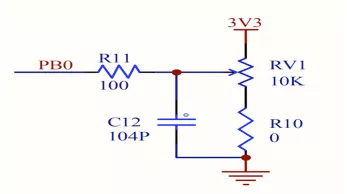

This solution is tested and verified based on the MM32 BLE_Test Board . In order to simply simulate the collection and processing of sensor signals, in terms of hardware principles, this solution directly uses the ADC potentiometer RV1 on the DEMO board to adjust different input signal conditions. The signal is connected to pin PB0 , which can be reused as AD sampling channel CH8 ; use PB1 to connect to the green LED indicator light, which can be used as an indication of Bluetooth connection status , and the low-power wake-up pin selection PA0 is configured as a pull-down input ;The Bluetooth-related function pins are consistent with the solution introduced earlier, so we won’t go into too much detail here.
Figure Hardware schematic diagram
