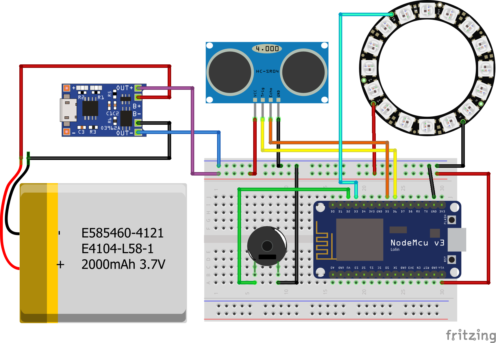

Hardware components:
A 360 mAh 1S 30C/60C lithium polymer battery pack (LiPo)
A TP4056 1A lithium-ion battery charging module with current protection - mini USB
A SparkFun ultrasonic sensor HC-SR04
A buzzer
An ESP8266-based NodeMCU ESP8266 Breakout Board
One Adafruit NeoPixel LED Ring: WS2812 5050 RGB LED

Blockdiagram
