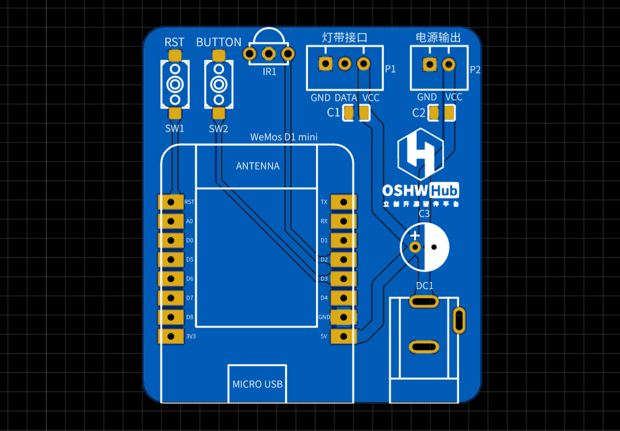

The WiFi/serial port WS2812 control board has a variety of control methods and lighting effects, and can also achieve the display's Ambilight effect. The firmware uses the Github open source WLED project, and the ESP8266 module is D1 mini.

The D1 mini module requires welding pin headers, pay attention to the pins and insertion direction!
For the method of flashing the firmware and other instructions, please refer to the WLED project official Wiki.
WLED firmware (using WLED_0.x.x_ESP8266.bin) tool ESP Home Flasher
Prismatik for computers can support the Ambilight effect of serial ports and wireless displays . If the light bar is too long, you need to supplement the voltage, or use a 12V powered WS2815 light bar. If you think it’s good, you can give it a like.Or three clicks
