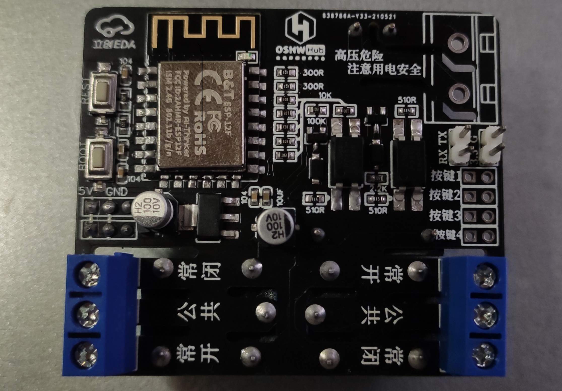

A 4-way IoT switch designed based on the lighting platform, supports Xiaoai, Baidu Xiaodu, Tmall Elf, and voice control. The circuit board size is about 60X52CM and can be placed in the switch box to turn ordinary lights into smart switches while retaining the physical switch. . You can also use physical switches as limit switches to transform smart curtains (but you have to put more effort into the hardware), etc. Personally, I feel that ordinary equipment and home appliances can be made intelligent by using the IoT module to control the high and low levels of the pins and adding a peripheral amplifier circuit to control the device switch.

Since the design is to be placed in the switch cassette, only two relays are placed on the board and the other two are external relays that lead to the IO port. It also has an external burning port for use when changing programs.
As for the program, I have just come into contact with it. The uploaded program is personally used with a circuit built on a development board, and it is currently in good condition when connected to Xiaodu. Moreover, most of the programs have Chinese comments, which should be easier to understand.

There are two external interfaces, two relays and a Hailink power module on the back of the circuit board. Too much washing water has ruined the silk screen of the power module!
front!
Homemade 4-way switch panel for debugging!
When the board is burning the program, the board burning port and the connection of the writer

In the video, I forgot to introduce that the 4 buttons in the APP can also control the device! My personal level is limited, so I would like to ask the passing experts to give me some advice and help me optimize the program. Thank you! ! !
