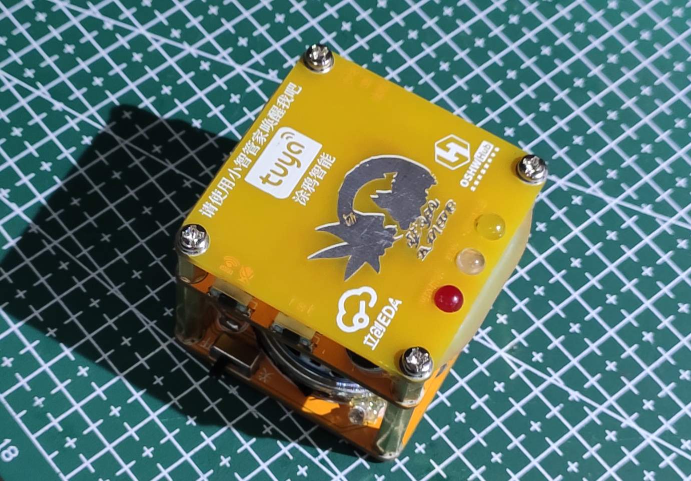

An online voice universal remote control controlled by Tuya VWXR2, with built-in infrared control of RGB atmosphere lights. The overall design is to divide the circuit into three PCBs of the same size. The four fixing holes of each PCB are connected and transmitted through copper pillars. The purpose of this design is to omit the shell design of the voice remote control group. It’s not ugly when assembled. Two RGB lights are placed on the top layer and controlled by infrared to switch and change color. The middle layer is the Tuya VWXR2 main control and buttons, infrared receiver, microphone, etc. The bottom layer mainly houses the infrared transmitter tube and speakers as well as the power interface and power switch. Moreover, Tuya’s online remote control is free of development and does not require coding. It can also be used as a gateway. You can control other Tuya products with voice, and can broadcast weather, time, Baidu Encyclopedia, etc.! ! ! !
Next comes the making process!
The upper, middle and lower parts are PCB boards.
Materials used.
PCB manual tin implantation.
For component welding, it is recommended to use an LED desoldering station for SMD components, which is simple, cheap and easy to use.
Weld the horn.
Cut foam.
The speaker is glued with foam cotton to insulate the middle and bottom layers and fix itself.
The middle layer is connected to the bottom copper pillar.
Mid-level detail.
Completed renderings.
Later, the edges were wrapped with thin frosted plastic boards to increase the overall beauty! Please see the attached video for the next physical demonstration! ! ! If there is room for improvement, please let me know! ! Thanks! !
Finally, if you want to make a shell, you can refer to this link of mine ! ! Please forgive me for not doing well! ! !
