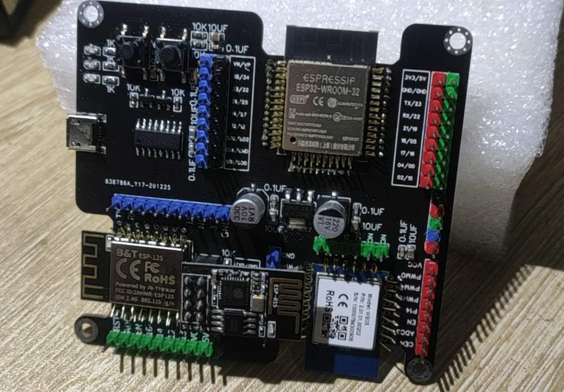

ESP32/8266/ESP01S programmer, all modules have been programmed without any problem (and they are all programmed automatically). Tuya XR3/WB3S debugging board. During debugging, the external circuit is connected through the pin header. To debug the Tuya DP point, you can connect the board Use the external programming port for debugging. Each module power inlet is passed through filter capacitors. This board is based on the open source platform's programmer. Those who want to make can also go and see their projects.
