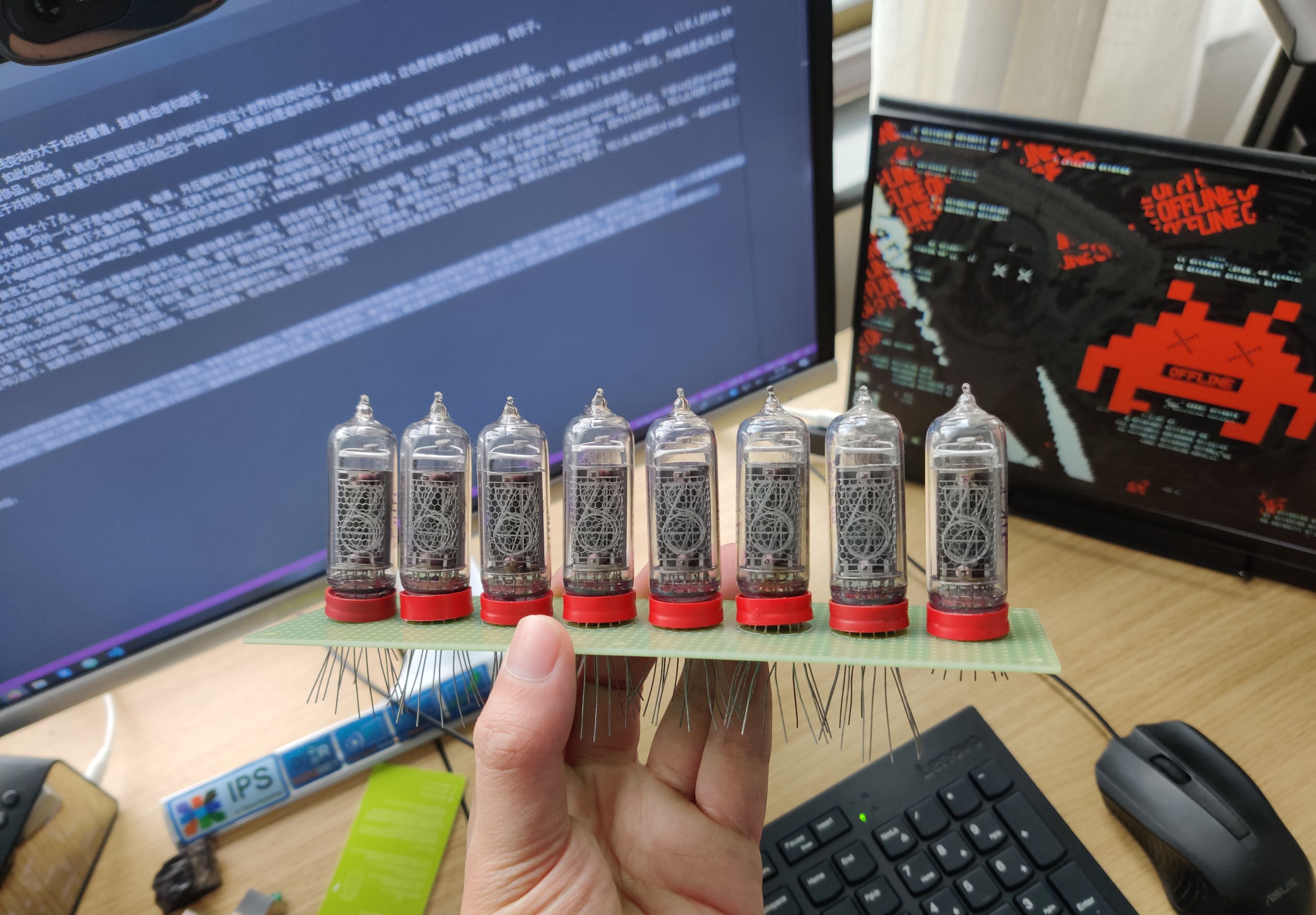

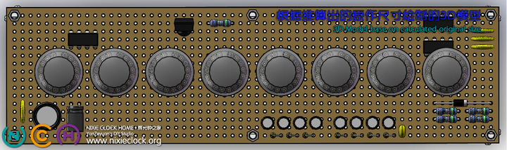

This project is the top plate of the world line fluctuator, which is used to install Nixie tubes, decorative devices on the top of the world line fluctuator, and the infrared receiver on the top. This board must be printed on one side. I was slightly affected by the epidemic when I printed the board. Printing boards of other colors will cost extra, so I can only use green cover oil. When printing, please remember two things. On the one hand, you must Use black or yellow cover oil and print on one side. As for the BOM table, it is recommended to use the devices in the schematic diagram of this project. I have counted them one by one. It is recommended to directly export the BOM table, purchase it yourself, and solder it according to the picture below. Here is a very useful way to install Nixie tubes on the perforated board. Cut the pins of the Nixie tube to be shorter than the previous pin, and then install each pin on the perforated board in turn. Due to packaging reasons, it is recommended to retain the Nixie tube anode as the longest pin and plug in the anode pin first. As long as the anode pin is plugged in correctly, nothing else can go wrong. IMG_20200328_081431.jpg In addition, just in case your understanding is limited, you need to put the board without oil cover, put the exposed side of the board close to the bottom of the Nixie tube, and then solder and fix the Nixie tube and other components from the other side of the board. Another suggestion is to solder only two pins of the Nixie tube to this board, because the Nixie tube is easy to break. If the tube is replaced, it is best to fix only two pins here to facilitate future replacement. Show two more pictures. IMG_20200328_081442.jpgIMG_20200328_081437.jpg
