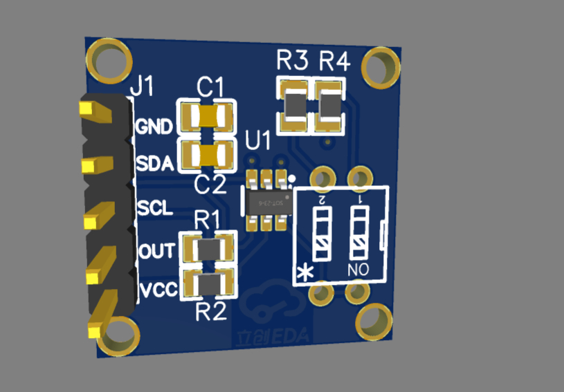

This project is used to verify the solution verification board design of Lichuang Mall digital-to-analog conversion chip MCP4725A0T-E/CH
This project is a sample project for the Solicitation Order for Lichuang EDA open source hardware platform solution verification module .
The DIP switch is used to change the 12C address (default is 0x60), when pulled low it is 0x60, when pulled high it is 0x61
