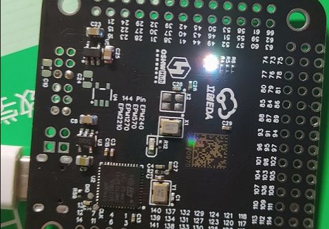

MAXII CPLD core board
  • [ ] Form Factor: Iris Cube Basic Small ( https://oshwhub.com/Iris-Cube/ICBasic )
  • [ ] Compatible with 144PIN EPM240, EPM570, EPM1270, EPM2210.
  • [ ] introduces almost all IOs and labels the pin numbers.
  1. 1 common anode RGB LED;
color IO
red 69
green 67
blue 68
  1. 1 USB-blaster status light;
    • 1 keeps flashing when power is turned on (the logic has not been written yet, gurgling
  2. 2 active crystal oscillator bits;
    • The crystal oscillator power supply is the same as VCCIO1;
    • Two GCLKs of bank2 are introduced;
serial number IO
X2 20
X1 18
  1. VCCIO selection jumpers for bank1 and bank2;
    • Optional 1.8V, 2.5V, 3.3V;
  2. Lead to 108 IO;
The firmware is in the picture below
