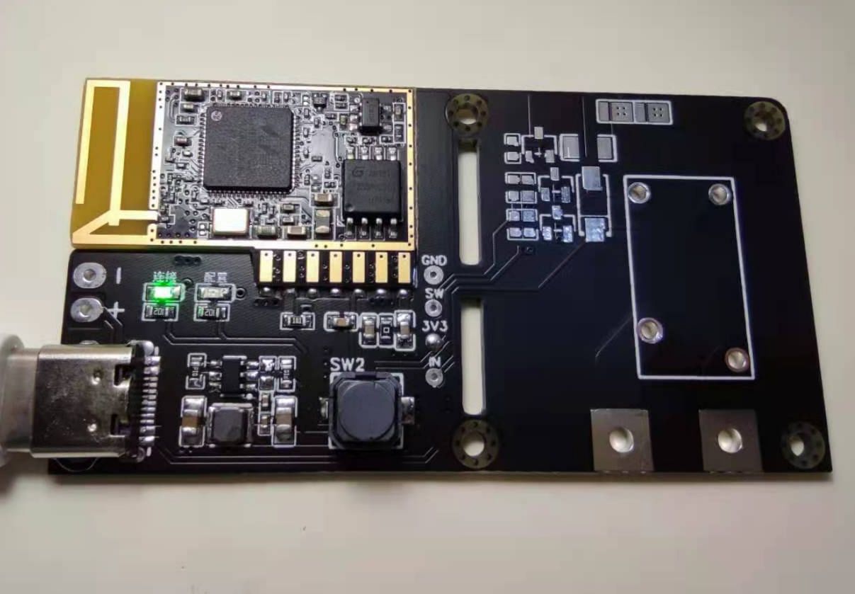

Xiaomi WIFI socket basic module
This project is the smallest system with a built-in WIFI module in the basic version of Xiaomi WIFI socket. If you have a broken socket at home, you might as well give it a try~
The module uses SY8120 power supply and supports up to 18V power supply. Use TYPE-C interface and reserve a power interface for convenient power supply.
The right side is an expansion module, which can control one light or one relay. You can also cut off the right module to keep the minimum system usage.
