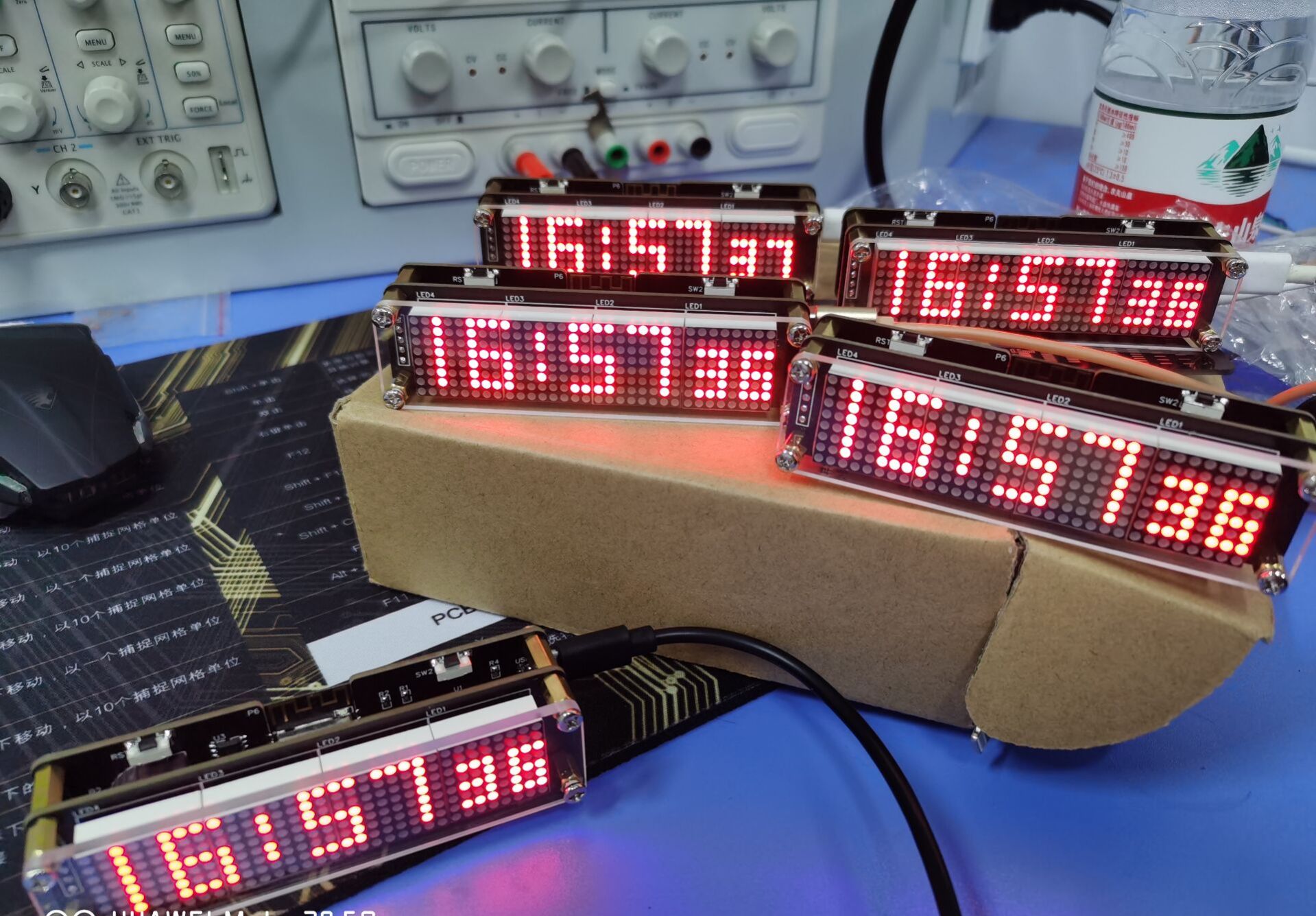

Intelligent electronic matrix clock
Note: The production of this electronic clock has been completed, and the effect is as shown in the video resources given below
       All information about the project is placed in the project attachment.
1. Introduction to electronic matrix clocks
        This electronic clock needs to be configured through the mobile phone software EspTouch. When a battery is installed, the time information can be displayed normally even after powering off and on again after the network distribution. It is controlled by the wifi module ESP8266-12S and programmed with Arduino. The time information obtained from the Alibaba Cloud timing service platform is converted into SPI communication through the program and transmitted to control four 8*8 dot matrix driver chips MAX7219. Each MAX7219 acts on the corresponding 8*8 dot matrix screen independently, and RST The buttons and SW2 button are for more convenient downloading of programs and resetting the ESP8266 module.

3. Circuit design ideas
         Observing the circuit diagram, we can find that two connection methods are used at the USB interface, namely TYP-C and micro port. They are placed symmetrically, which not only makes it more convenient for users to use, but also makes the circuit safer and more reliable (when placed symmetrically , if the TYP-C data cable is inserted, the micro interface cannot be used. If the micro interface is used, the TYP-C interface cannot be used, which has a restrictive effect, but also allows users to choose the interface they want to use.)
          The circuit board has rounded corners. The rounded corners of the circuit board not only make it easier to use, but also improve the safety and aesthetics. This is also the product value of this matrix clock. At the same time, the wifi antenna part is also improved. Hollowing out and rounded corners, if placed during use or carrying, the right-angle slot between the PCB and the module may catch on clothing or skin surface, causing damage, etc.
          The connection between the motherboard and the top plate is made by using pin headers and female headers, so the height limit is mainly related to the pin headers and female headers. If some friends think the height is higher, they can use a rigid-flexible PCB or connecting wire to design the connection. , but the main idea remains unchanged
4. Product appearance design
          The top surface of the product uses a 4mm transparent acrylic board. The mainboard PCB and the top PCB are connected using 11mm copper pillars. The top PCB and the acrylic board use 6mm through-hole copper pillars. There are a total of 8 M3 screws on the top and bottom. to fix
