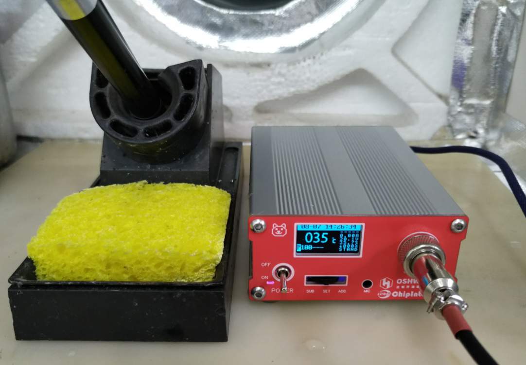

1. Introduction to project functions
The voice control electric soldering iron T12 is convenient for controlling the temperature by voice when debugging the soldering board. Especially when both hands are free, there is no need to manually adjust the temperature to facilitate soldering and improve efficiency.
It can be said to be a siege lion weapon (crossed out).
Using HK32F103C8T6 (STM32F103C8T6) and Qiyingtailun voice chip CI1102 (CI-B02GS03T (Tuya IOT) module) C2759837.
Use PD power supply, or DC port, 24V-12V (low voltage will heat up slowly). OLED display.

The basic functional verification has been completed, the bug writing is a bit messy, and the program is still being improved and optimized. . . . . .
The front panel PCB has not arrived yet, let’s assemble it first to see the effect.
---------------2021.8.2----------------------
The firmware of the voice module has been updated to avoid the problem that only one of the two pronunciations of "二百度" and "二百度" can be recognized.
Solved the problem of occasional misplacement of wake words. The firmware and firmware production files have been uploaded as attachments.
The program is completely open source, and STM32 is currently used. MDK5.
I replaced the MIC with better sensitivity (the MIC used in Bluetooth headsets) and re-recorded the video.
For a clear version, please see https://www.bilibili.com/video/BV1eg41177YB
---------------2021.8.7----------------------
The front panel was installed, the aviation plug was welded, and the program was updated.
Add soldering iron sleep, use the vibration switch of the handle, sleep without action for 100S, and reduce the temperature to 160 degrees. It can also be controlled by voice.
The soldering iron temperature smoothing filter has been changed to stabilize the temperature and not jump around when the temperature is high.
A simple dynamic temperature display bar has been added.
Added a program to play local announcement sound.
Added power switch function.
Added the function of playing bad apple (useless). Play at full speed, no time adjustment. It seems that the voice module cannot accommodate such a long audio, so no audio is added.
The video was recorded again.
