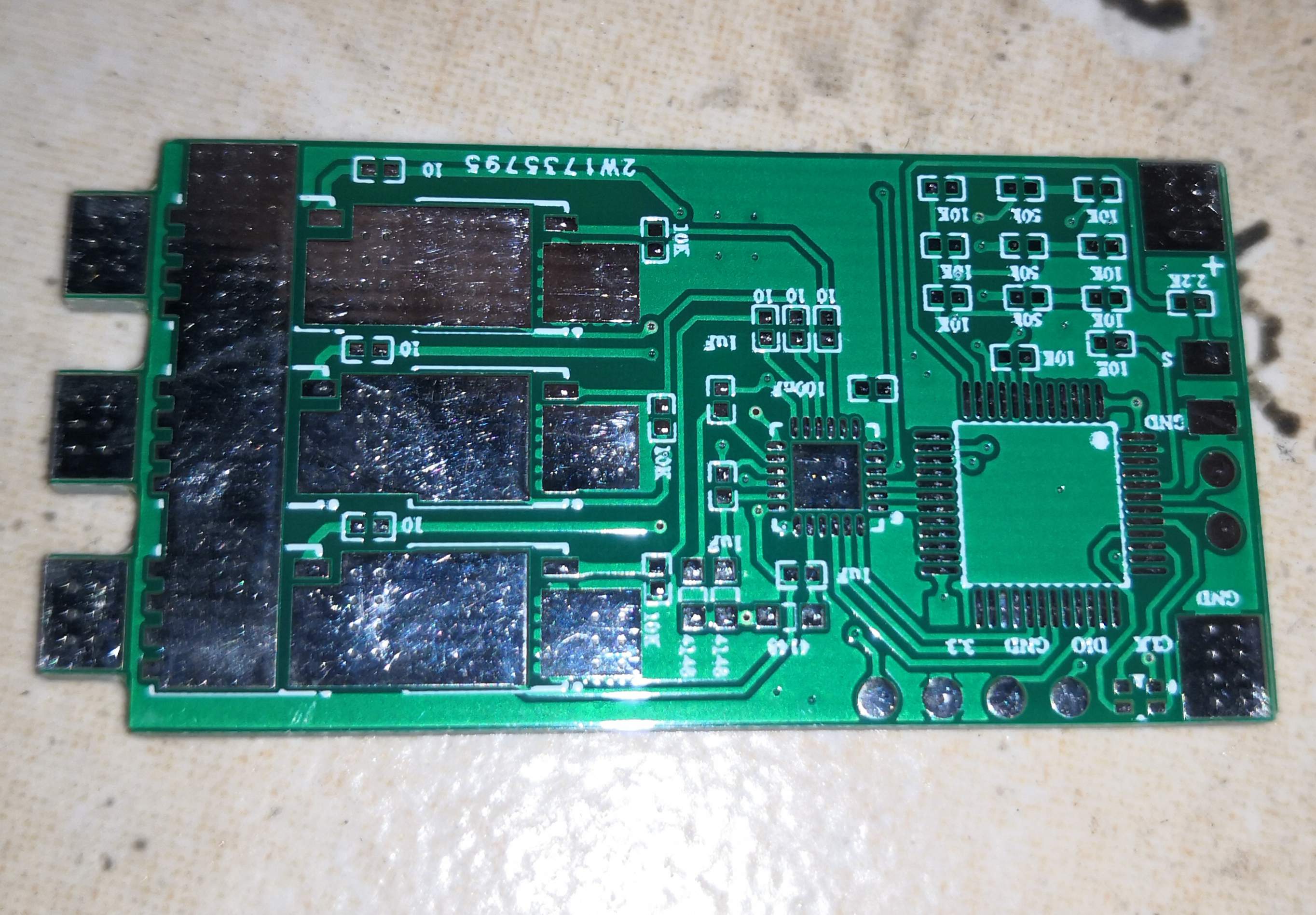

stm32f051 brushless ESC
The original version did not have silk screen printing and the layout was not good, so I re-edited it. Attached is the firmware and code. However, debugging this ESC is more troublesome. It seems that it can only be debugged with G4, F4, F7 and other flight controllers.
I have compiled it many times, but it doesn't work. I'd better use the old version. It has implemented several modes, and there is no problem in both directions. You can also redesign the PCB to make it brushless for high-current vehicles. Attached is the engineering code.
I have some materials used to make Luoli brushless. The resistance and capacitance are all 0402, which is really difficult to weld by hand. 1614004821930.jpg
