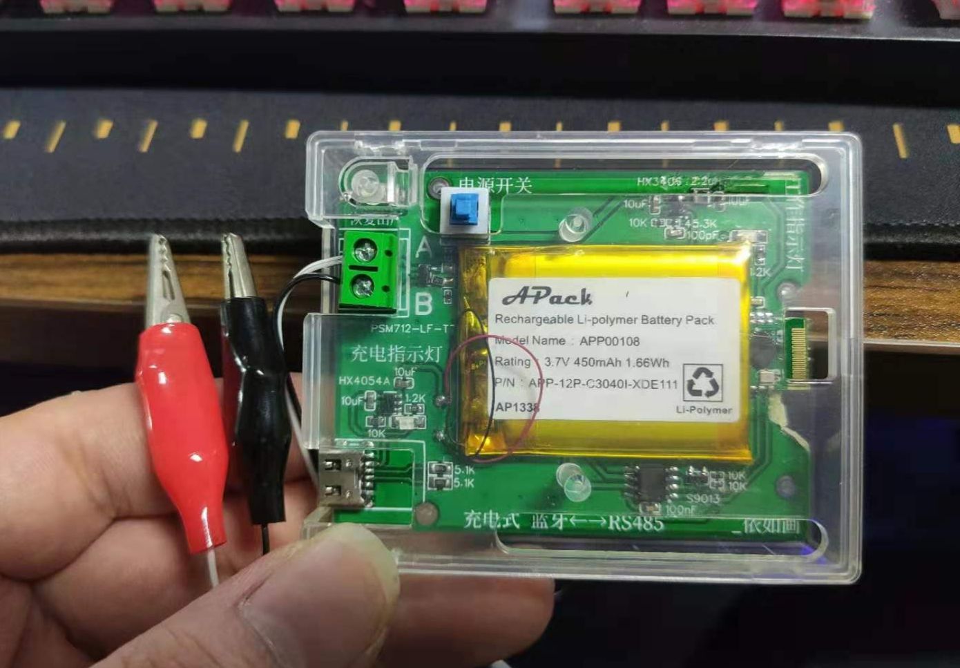

BLE-SER_CH9140 Bluetooth ←→ RS485 module creates a virtual serial port directly on the computer, which is basically the same as ordinary RS485 (serial port to 485). WeChat applet and mobile APP can also link to the Bluetooth module for RS485 testing.

The battery uses the long-collected Laowang 450mA 3.7V lithium battery (upgraded on the basis of the 200mA Bluetooth to serial port). In order to stabilize the output voltage of 3.3, the discharge is from 4.2 to 3.3

The front of the real thing (the first version of Bluetooth is copper-filled, and the second version has been modified)
