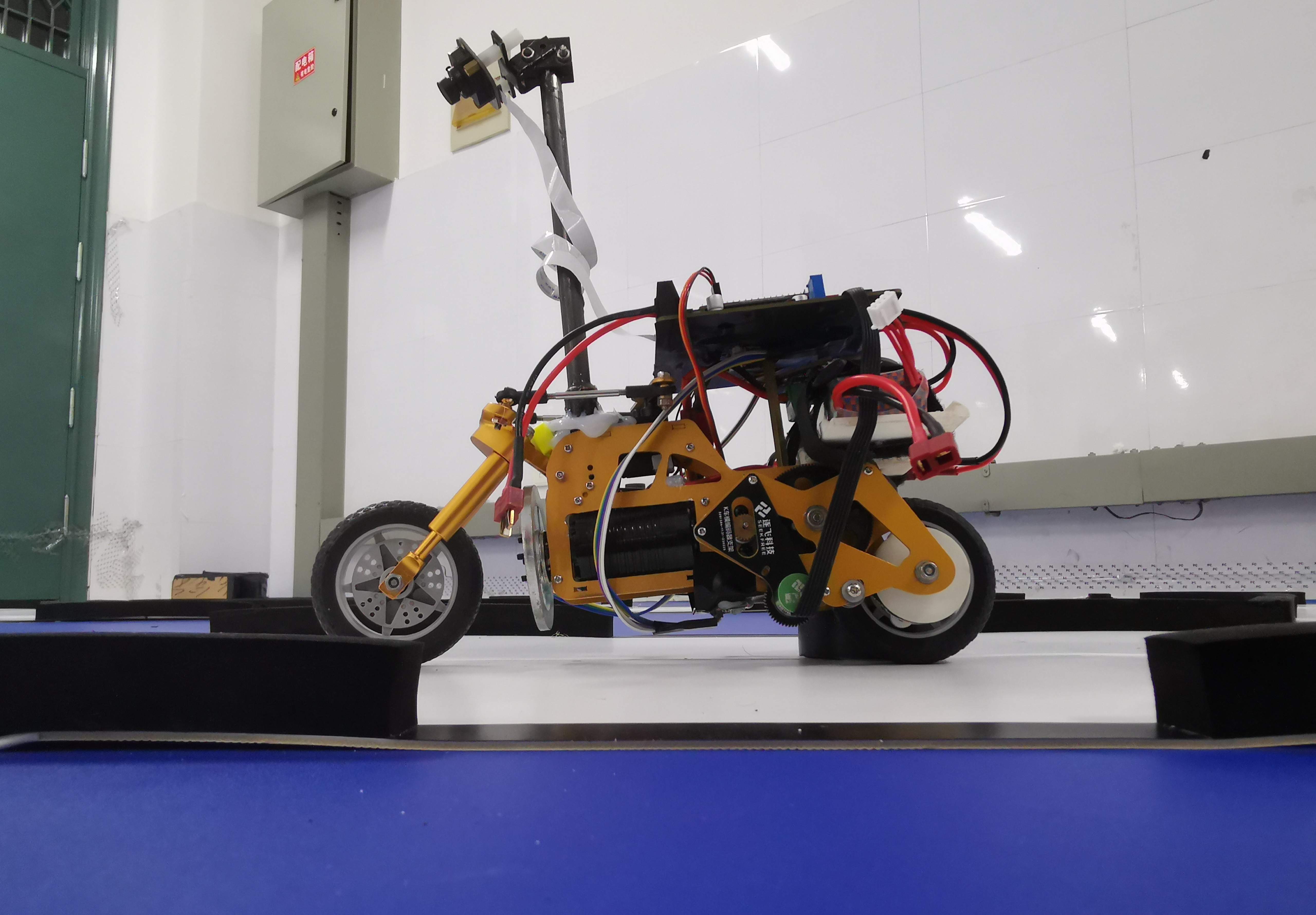

In fact, I made many versions, mainly because I wanted to try it out. Yes, if you have an idea, how can you not try it out? I won’t say more. Look at
the picture above and look at it again and again . You think it’s over, but it’s not ... Finally: The source file of the demonstration video is posted in the network disk. You can download it if you want. The link is as follows: https://lecloud.lenovo.com/share/wF14vw4HVUYNkE2C
