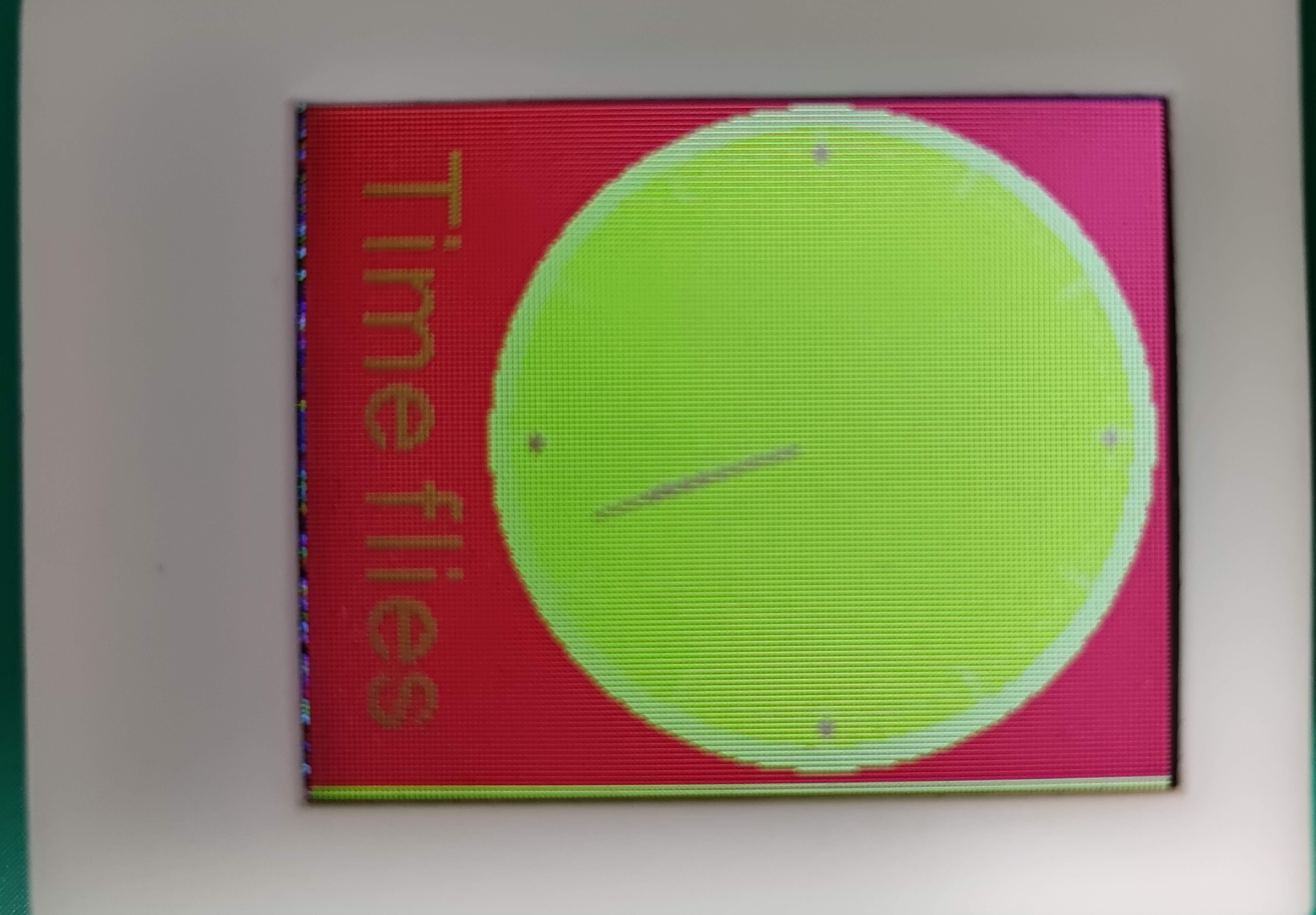

Use ESP12F to drive TFT screen display. There are two USB to serial port chips in the schematic diagram. It is recommended to choose CH340C. It can be downloaded automatically. If the smallest size is required, CH340E can be used. I put two displays, one is 1.8 inches, and the other is 2.4 inches, you can choose it yourself. The package modifies itself.

7. Display pictures
Displaying images requires the mold taking software lcd-image-converter
Adjust the pixel size of the image to not exceed the screen size -> Click File->Open->Select the image->Options->Conversion...->Set as shown in the interface->Shoe Preview->Copy the array
The mold taking is now complete.
Create a new jpg.h file, and save the array just copied moduloly within the braces of the const unsigned short bmp[] PROGMEM={}; statement.
