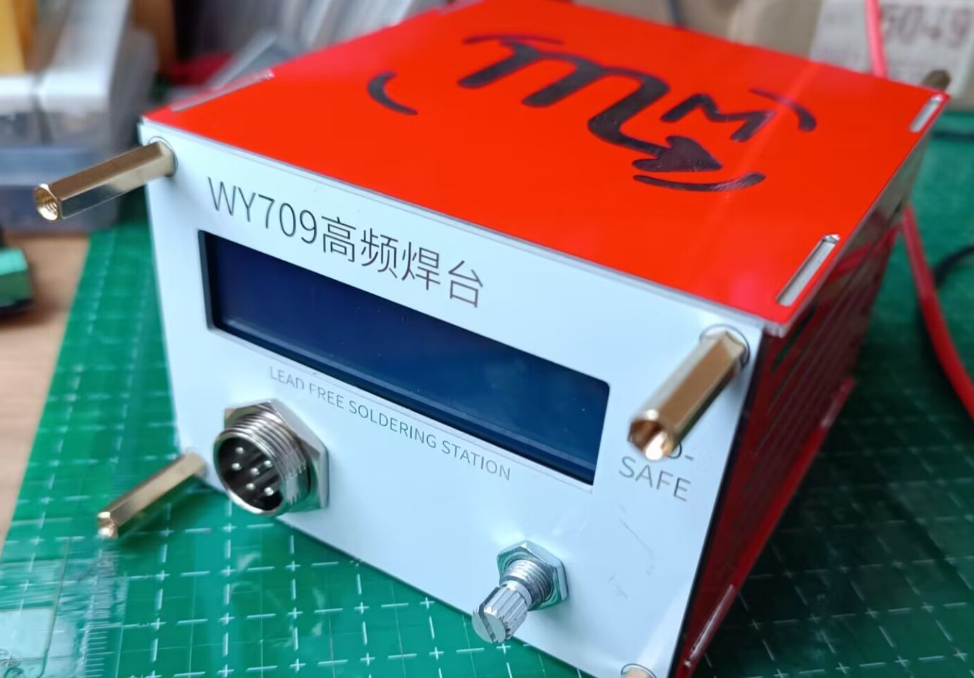

WY709 high frequency soldering station-shell
The front and rear panels of the shell suitable for WY709 high-frequency soldering station
are modified from the copper pillars shared by Wenyu soldering station group. They
are used to fix the front and rear panels. The outer copper pillars are for the convenience of assembly. After the internal welding is completed, remove them and replace them with corresponding M3 screws
. When welding the control board, pay attention to fixing the aviation socket to the front panel before welding, otherwise there will be steps that will affect the installation.
