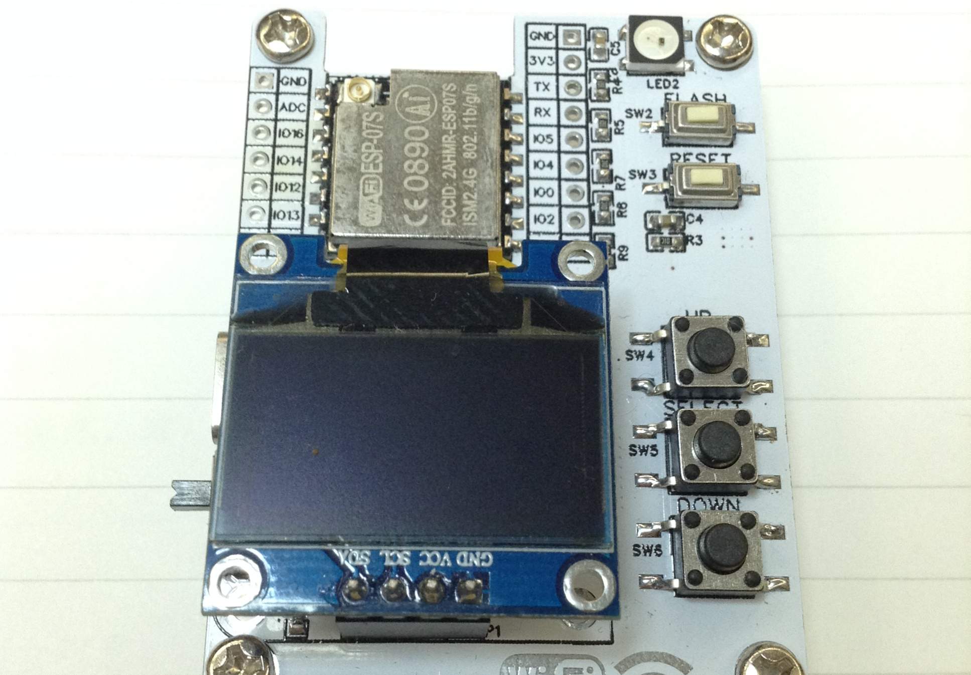

8266 WIFI "Tester"
The program is an open source project: https://github.com/SpacehuhnTech/esp8266_deauther
When using this project, please comply with relevant laws and regulations.
  • Able to disconnect users connected to a certain WIFI by sending Deauth packets
  • Able to create up to 32 SSIDs with different names and refresh the WIFI list (useless)
characteristic
  • Can be controlled via OLED screen and buttons, no other equipment required.
  • You can also connect to WEBUI and control through WEB interface
  • RGB LED display status
  • Built-in CH340 automatic litter circuit
  • ESP-12 ESP-07S compatible
  • TYPE-C interface
o0n6cN2m3ComX4fps1xRQIpeYXQPybbgkVdn8TNd.jpeg9sStAPMrBTBCJwuqE5DZyeq1qZFYhI7rMQfgNMZW.jpeg
