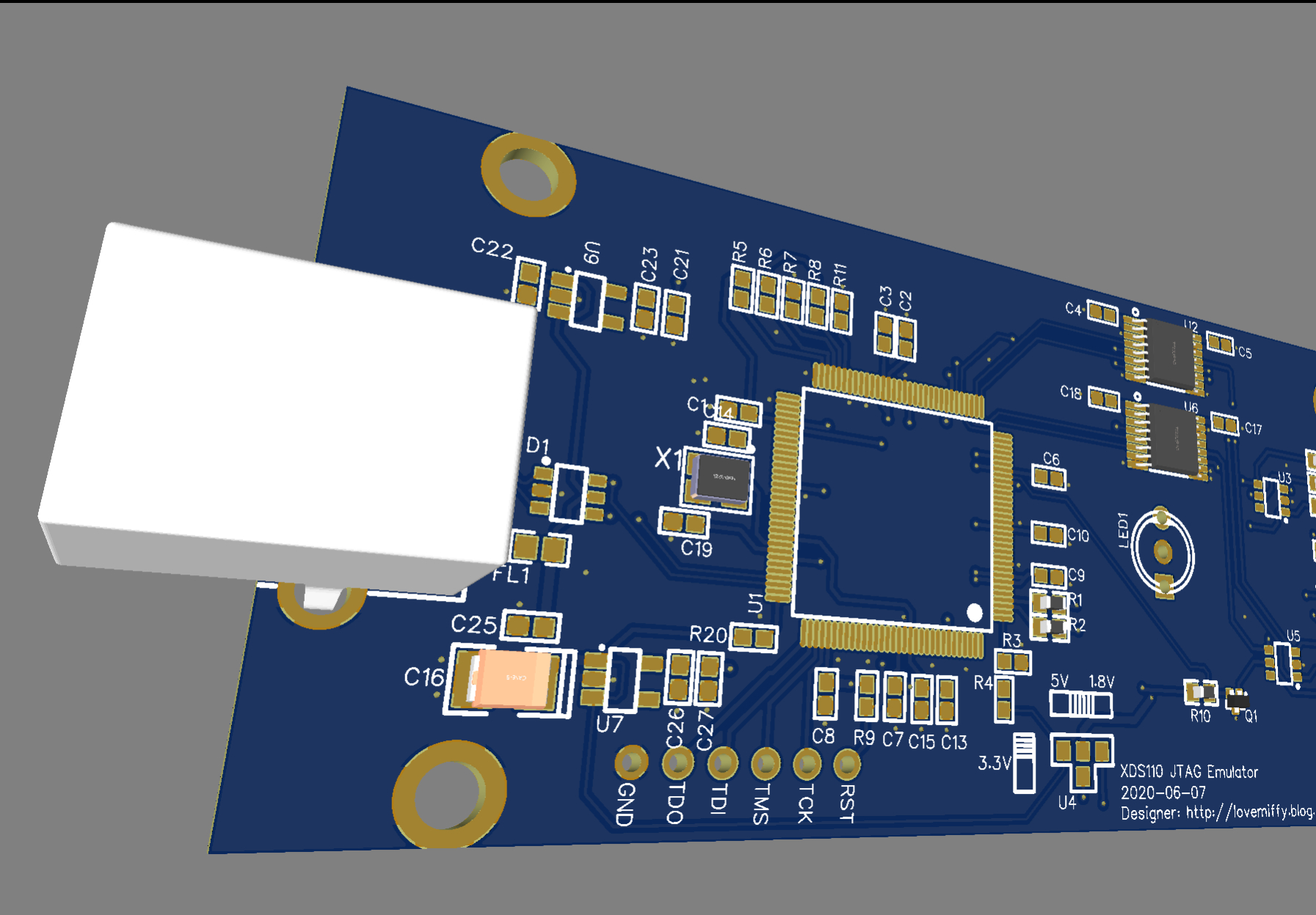

XDS110 TI emulator
The download speed of the XDS110 emulator is much faster than that of XDS100V3 and V2. It is a product between XDS200 and XDS100. It perfectly supports the latest TI CC26xx protocol stack chip firmware download and simulation. It has been verified and works normally. The one that claims to be non-Lite is too powerful. A certain online store cut corners and bought only one main chip and nothing else.
All kinds of JS are welcome to plagiarize
  • Supports ESD bidirectional protection, USB port ESD 15KV protection, JTAG port ESD 15KV protection
  • Support 74HAVC series chip level conversion, weld different 0 ohm resistors through U4, select the target IO level, support three IO chips of 1.8V/3.3V/5V
  • Add a 100uF tantalum capacitor to the 5V position to increase the stability of the system power supply.
  • Because of the annoying thing about Lichuang, although it is open source hardware, the schematic and PCB can only be opened and viewed, and cannot be directly copied and pasted for use., currently tested, you can open it directly, then click on the upper left corner to save as to become your own project WeChat picture_20200613151521.jpgWeChat picture_20200613151516.jpg
