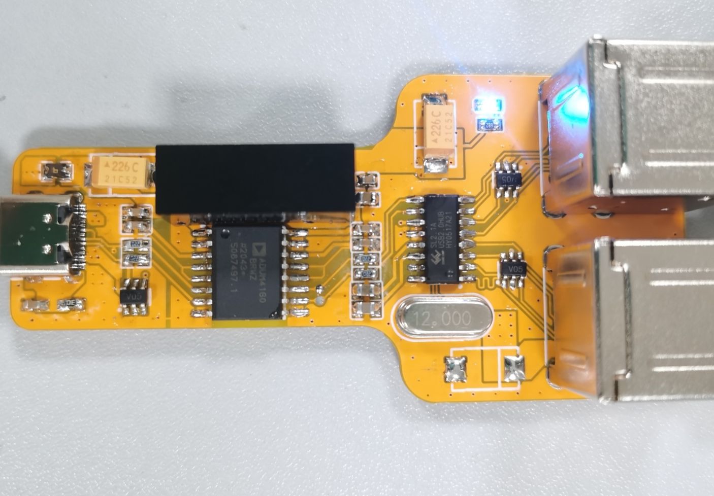

Isolated USB HUB, used for development and debugging of high-voltage equipment, etc.
  1. V0.1 has passed the sample test
    • You need to pay attention to the isolation DC-DC model. The packaging of different models may be slightly different. Read the specifications carefully, and be especially careful not to buy the non-regulated model of Jinshengyang (the one in my photo is o(╥﹏╥)o).
    • The capacitance on both sides is adjusted according to DCDC requirements and does not require a large capacitance. If you revise the version, consider changing the packaging.
    • There is a problem with the copper paving in the actual photo and needs to be adjusted.
