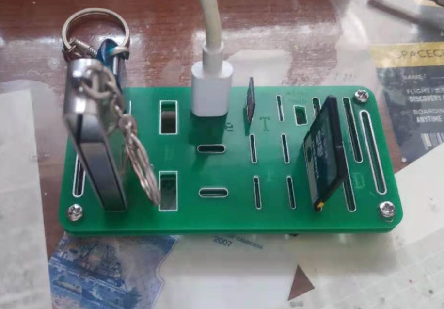

A simple storage rack
If you want to design your own version, I have a few suggestions.
First, all the lines around the interfaces are grounded and paved with gnd copper (as long as they are the same line), which can prevent the windows around the interfaces from rising due to poor workmanship by other manufacturers.
Second, consider the spacing between devices. For example, if the USB is placed too close, do you think it can fit the USB flash drive?
Third, my screws are m3*10, and the inner diameter is 3mm.
That's all, thanks for clicking into my project
