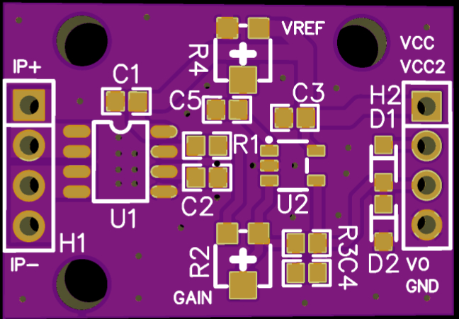

Current measurement is often required in projects. This solution uses the acs712 chip to implement current measurement and uses the operational amplifier lm321 for signal processing.
  • This solution uses ACS712ELCTR-05B-T as the core device to undertake the function of current measurement.
  • It is also equipped with some peripheral devices, such as lm321, for signal processing.
  • Use potentiometer to set the op amp
  • Reserve test points and corresponding pin headers
Features of this verification scheme:
  • Analog output bandwidth up to 80KHz
  • The default bandwidth is 34KHz, removing C1 can remove this limitation
  • Measurable current signal range from 10mA to 5A
  • Gain adjustable
  • Fully electrically isolated from the circuit under test
