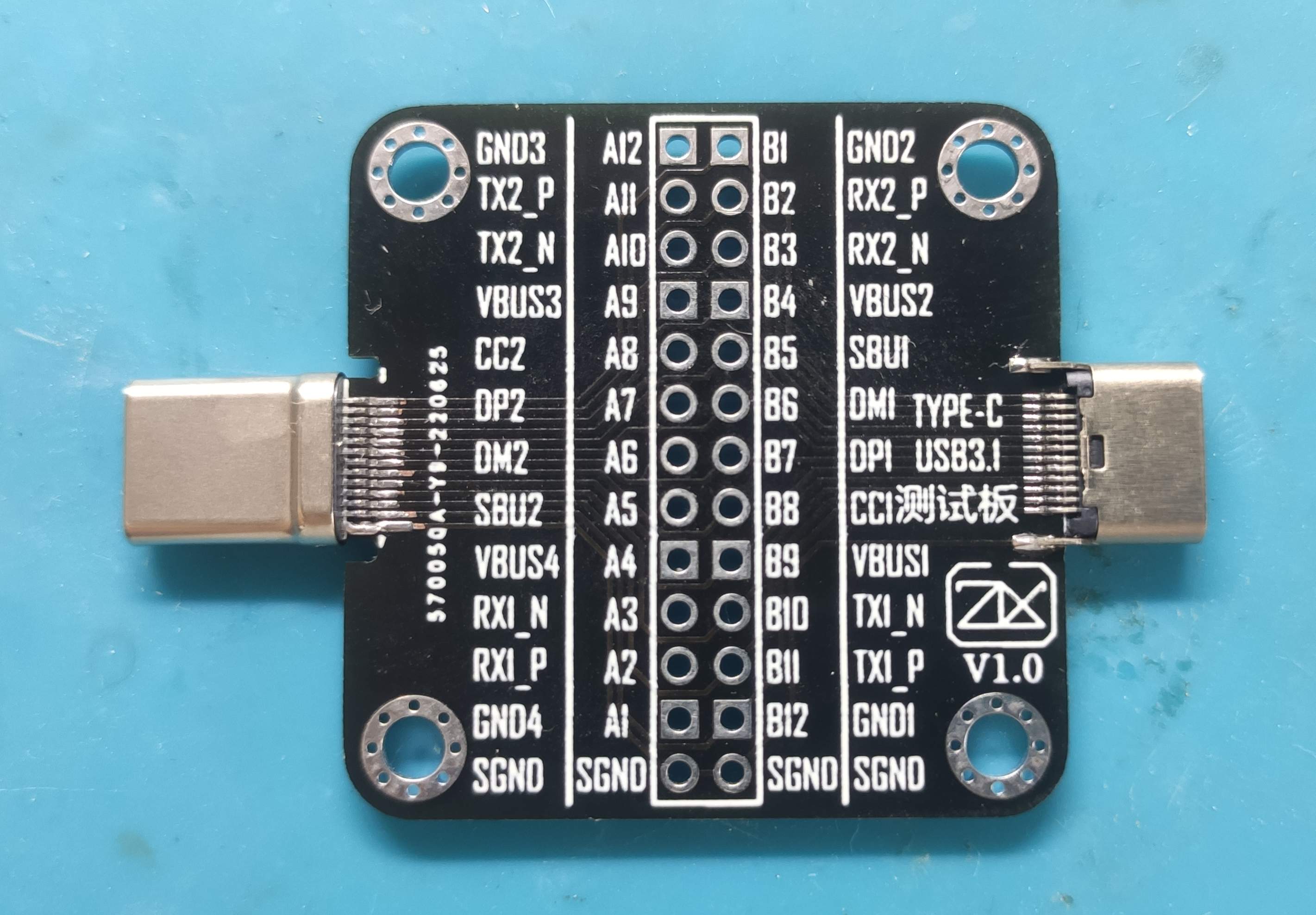

TYPE-C test board
2022-06-05:
Both male and female connectors use 24P full-pin connectors, supporting reversible plugging and USB3.1
The pin header is 2*13P 2.54mm pitch
The thickness of the board is determined according to the thickness of the TYPE-C plywood, generally 0.8mm
PCB size is 35*35mm double-layer board with 4 M3 screw holes
Male connector: C530605 https://item.szlcsc.com/550939.html
Female connector: C530610 https://item.szlcsc.com/550944.html
2022-06-30:
The board has been tested and verified that this solution is feasible.
