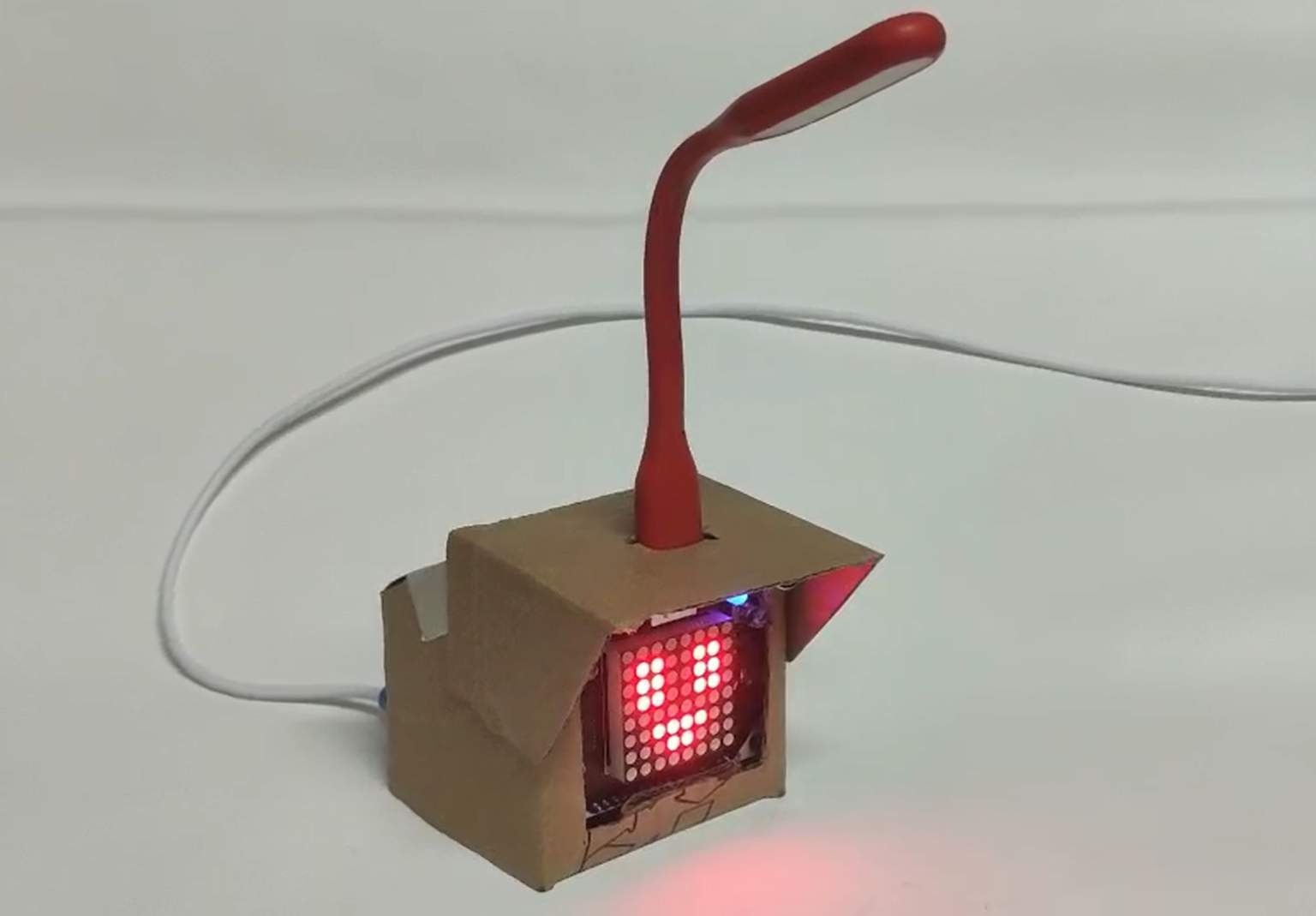

    This work is a multi-functional voice-enabled night light . We can interact with the desk lamp through voice, and let it turn on the light, turn off the light, and adjust the brightness. There are 2 infrared transmitting tubes on the control panel , so it can also be used to control home appliances by voice. The USB socket can be plugged into any USB powered device, the maximum power supply is 5V/2A    (try not to be close to 2A, the actual maximum is probably 1.5A!) .
   The small desk lamp has a built-in 900mAh rechargeable lithium battery, which can be charged using a commonly used mobile phone typec charger at home . With the battery, you can carry it with you, and there is no need for a wire to limit the placement of the small desk lamp, allowing it to appear anytime and anywhere. at your side. The design of the desk lamp is very user-friendly. When the small desk lamp is not awakened, it is in a dormant state and the dot matrix screen will not light up the expression. This means that it can be kept on and placed beside the bed during sleep, and can be called at any time. After waking up the small desk lamp, it will blink and make expressions like humans , which adds a little spirituality to the small desk lamp . A button is configured on the panel, click to switch the light switch state, double click to display the remaining battery power . In addition, there is a blue charging indicator light on the control panel , which will light up when charging and will go out after charging is completed. This makes it easy to observe the battery status and facilitate use.
  The small table lamp shell is made of paper (because I don’t know 3D modeling).
  I call the voice desk lamp Little B. Just call Little B and he will show his expression to interact with you. Below are the shapes of the small fan mode and night light mode .

  The hardware part is very simple. It is composed of two boards assembled using pin headers and female headers, and is divided into the following modules.
  1. ESP12F minimum system
  This is the main control, and the circuit is also fixed.
  2. tp4056 charging circuit
R8 in the circuit diagram uses 3k. This resistor controls the charging current. Because the 1A charging of tp4056 is too hot, the smaller 400mA charging is used.
3. DCDC 5V boost, 3.3V linear regulator
       There is nothing special about the power supply part.
4. CH340 circuit
     Connected to 8266 for easy programming, plus a typec port and a micro port. Both data lines can program the microcontroller.
5. NMOS driver circuit
     In this circuit diagram, C1 and C3 can be removed. This is the pad for debugging. Soldering it will not affect the circuit operation.
6. Power supply switching circuit
 It is implemented using P-channel. When there is an external charger input, the power supply is switched from the battery to USB.
  Hardware verification:
     All functions can be perfectly realized according to the schematic diagram, and there are no errors after verification. Below is the bare metal appearance.
