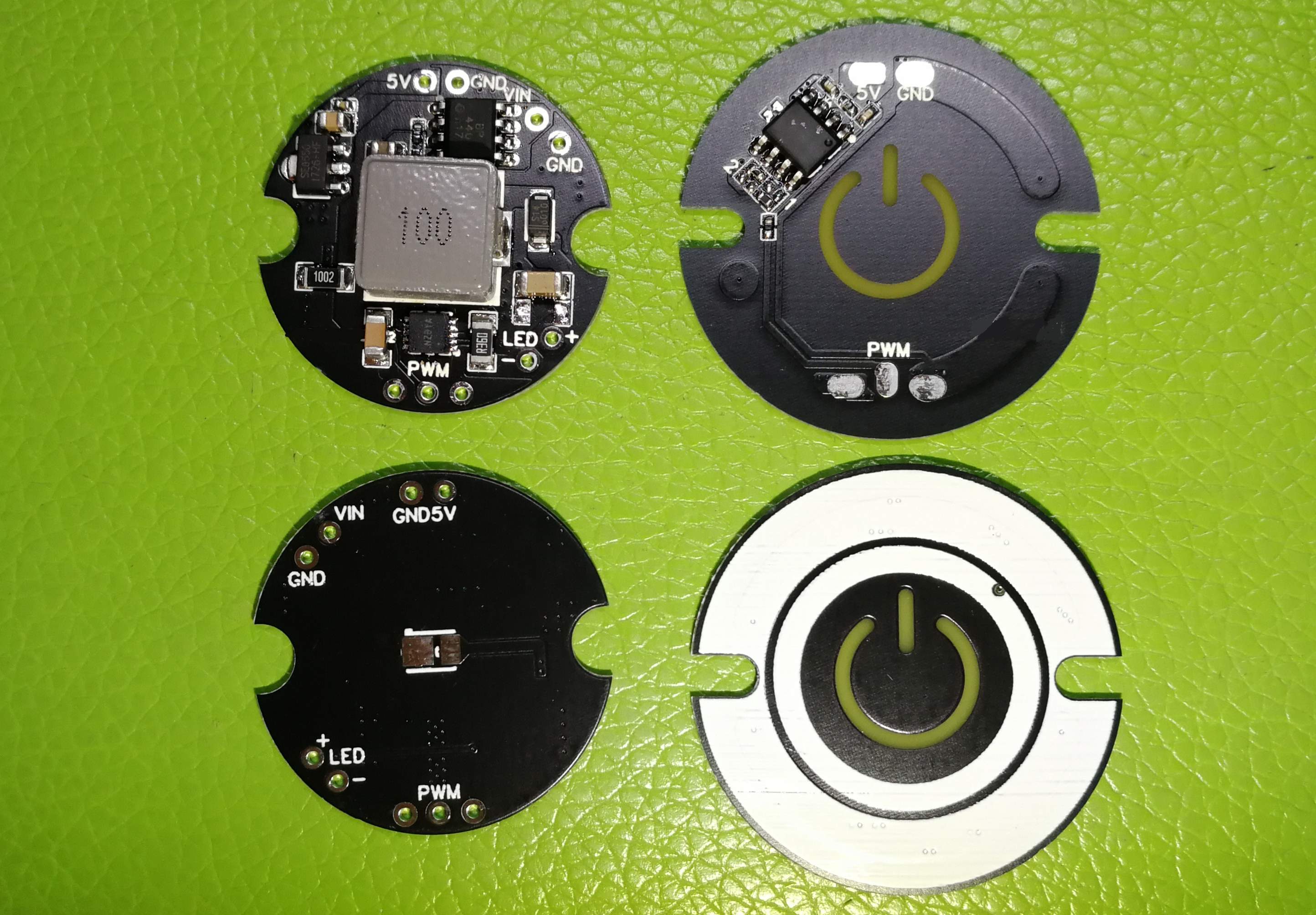

Work desk lamp modification board
The material is a cool lamp that I bought for 1 RMB Wallet Mail + a downlight heat dissipation for 1 RMB Wallet Mail
Input voltage: 5-12V (depending on LED voltage)
Output voltage: static maximum voltage
Output current: 555ma (constant current, modify the sampling to change the current)
Using RH6618 touch dimming chip, the default mode is stepless dimming with memory.
