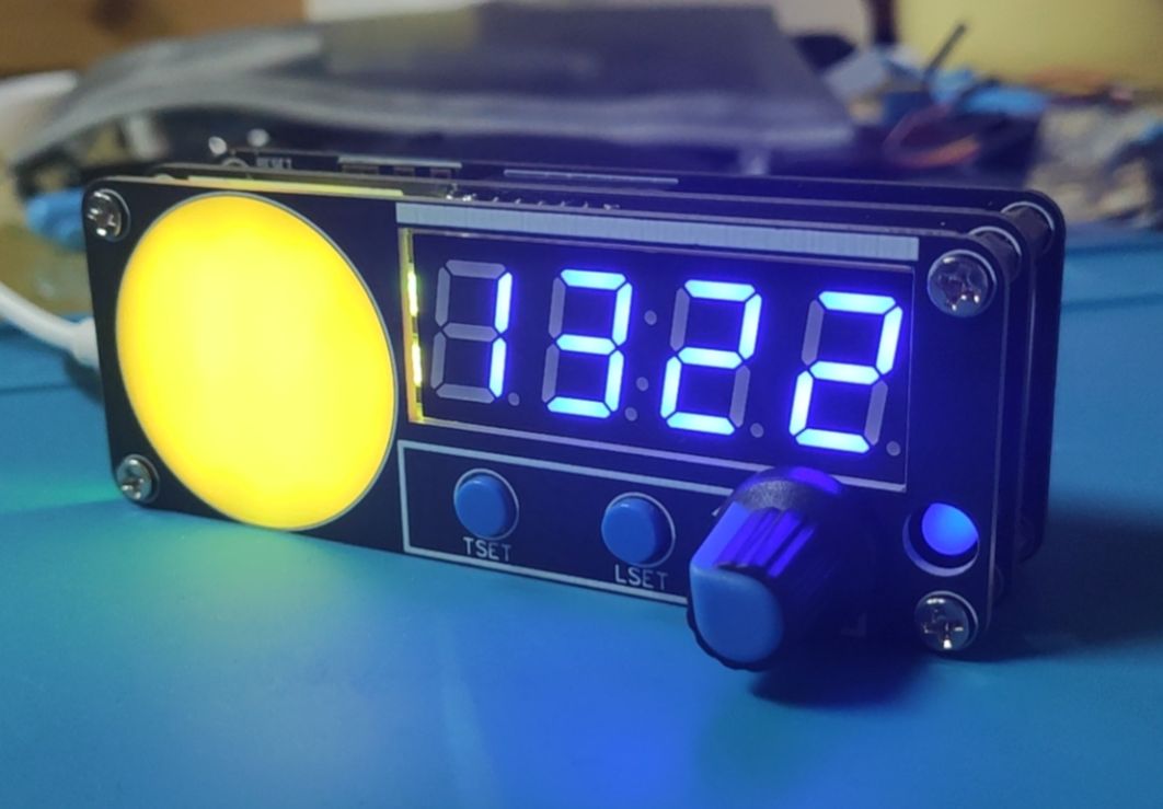

【Creative PCB】Moon Network Clock
Beautiful pictures to enjoy:
Hardware introduction:
   The hardware uses ESP8266 as the main control, 1637 digital tube driver chip, 1302 clock chip, ws2812 lantern, and buzzer as the main peripherals. The finished product is made of three layers of PCB stacked with copper pillars and pin headers.

Switch time display:
  Clicking the left button will change the displayed content, as follows
                                                                                                                                (minute/second mode)
                                                                                                                                  (date pattern)
Switch time mode :
After double-clicking the left button, the digital tube will flash. At this time, press the left and right buttons to select the number of digits to adjust, and then rotate the potentiometer to adjust the time. After the adjustment is completed, double-click the left button again to save the time setting and return to the initial mode.
