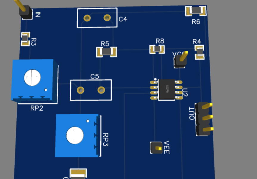

3. Filter part:
The filter circuit is a signal processing circuit that processes and processes the waveform and spectrum of the analog input signal, allowing the specified signal to pass while suppressing or attenuating signals in other frequency bands. Here we use an active RC filter circuit. The accuracy of the active RC filter circuit is higher than that of the passive filter, and the loss in the passband is also smaller. The filter circuits are classified according to the frequency response characteristics, including low-pass filtering, high-pass filtering. filtering, bandpass filtering, bandstop filtering and all-pass filtering. We usually analyze analog filter circuits in the complex frequency domain.
Using a multi-terminal negative feedback circuit
! [a.png] This is the core part of the entire circuit
. In addition, the op amp uses a common LM358
R3 with a resistance of 130K and a variable resistor with a series resistance of 100K. The magnification factor can be adjusted between 5-9.
The resistance of R2 is 2.2K, and a variable resistor with a resistance of 2K is connected in series. The center frequency can be adjusted between 1KHz-1.35KHz.
The reason for choosing these two parameters as variables is that changes in these two parameters have a low impact on other performances. In other words, the amplification factor and center frequency can basically realize independent adjustment
simulation and debugging
simulation. The software used for simulation is Multisim. It was found that the requirements can basically be met.
For more information, please refer to the documentation
