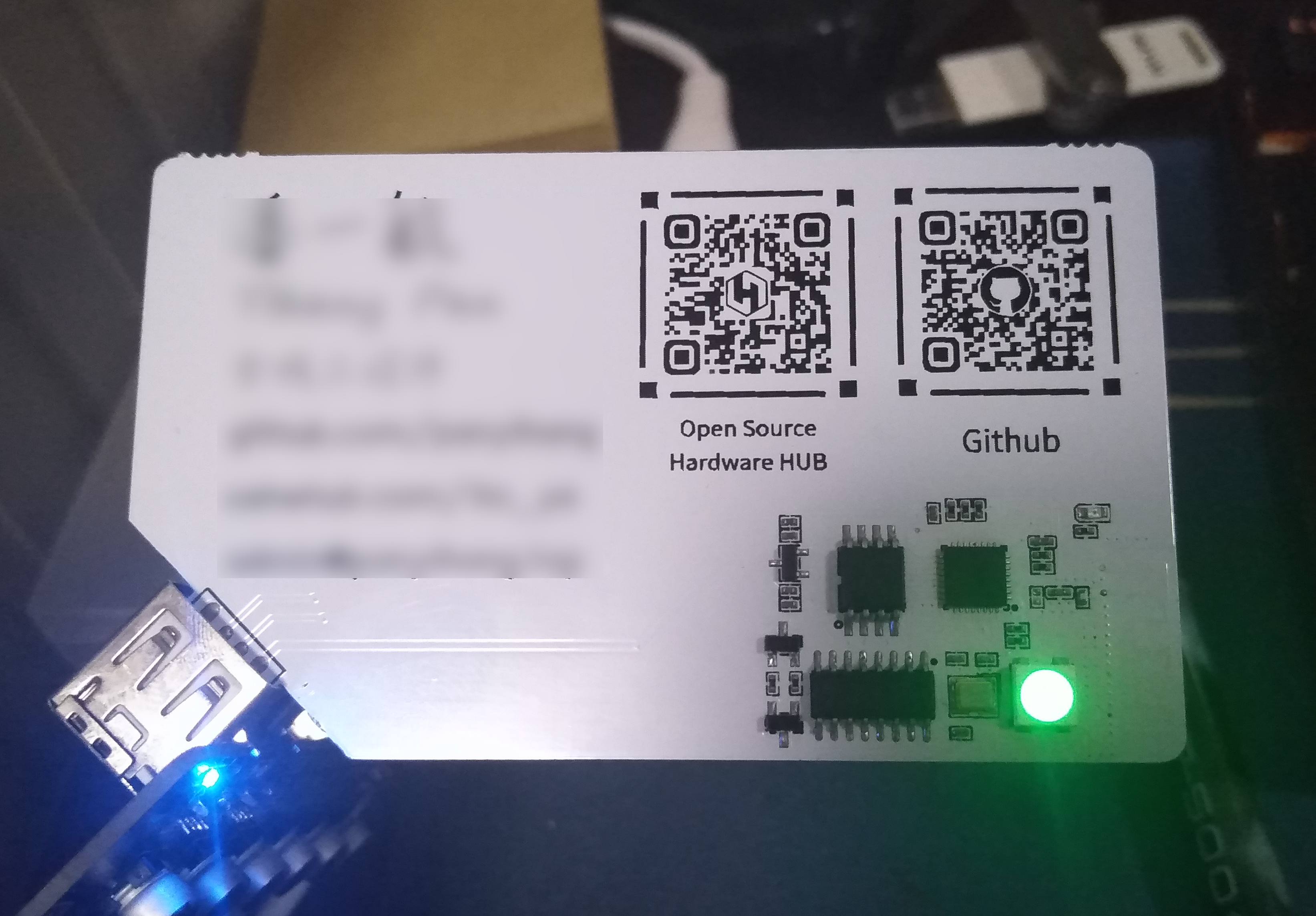

[Course Design] wifi personal business card
WiFi business card based on esp8266ex
It’s nearing the end of the semester and I can’t finish the document, so I’ll just make do with it.
"The code will be open source on Github, so stay tuned."

The idea of ​​the code for this board is quite simple. First, turn on the AP mode to create an unencrypted wifi, then turn on the dns service, and finally start the website. There are basically corresponding libraries on the arduino, which can be called directly

Then initialize the timer, file system, WIFI, DNS, and write the parameters according to the instructions on the back of the board.
The WS2812 on the board has a breathing light written on it. It uses trigonometric functions to control the brightness changes, and the display effect is more natural.
