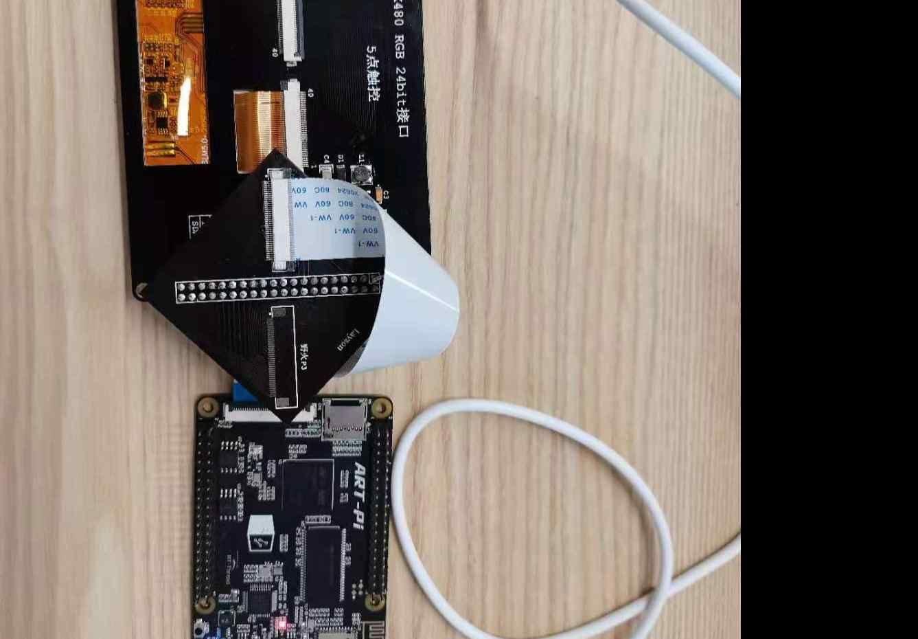

The LCD screen based on the ART-Pi development board supports the use of Wildfire's 5-inch and 7-inch RGB screens on the ART-Pi. You can edit the required inches yourself before making the board.
I am using the first version and missed one. 3.3V pin power supply (modified in this version) uses 5V to directly replace 3.3V in use
Project Introduction
This project was completely designed using LCEDA, and two versions were designed with reference to the pin definitions of the ART-Pi and Wildfire's GT917S LCD screens.
Version 1: There are headers that are directly plugged into the wildfire screen. They can also be used as ordinary pins when the screen is not in use (lead out more IO pins for use^_^)
Version 2: Two separate FC/FPC connectors are directly connected to the Wildfire's RGB LCD screen.
The materials I used were purchased directly from Lichuang Mall, including female headers and FFC/FPC connectors.
Note: Female headers are welded on the back of the board (as shown in the first version of the physical picture).
The first version of the physical picture display:
Second version of 3D diagram display:
