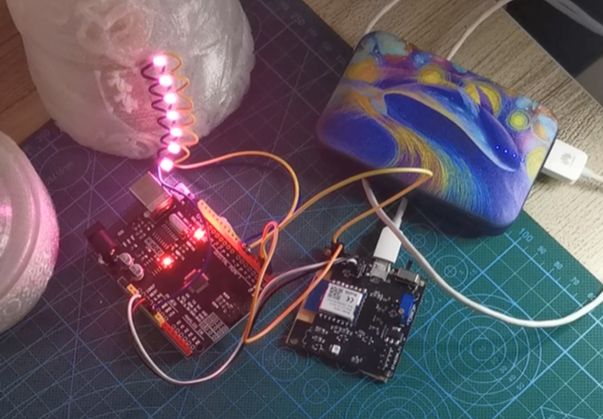

Use the Tuya smart module + MCU solution to design smart small lights (Tuya Cloud’s custom solution does not support personal firmware flashing, and is forced to use the MCU solution. Only the power supply and serial port interface need to be retained in the circuit). It has the following functions: 1. Brightness adjustment. 2. Color adjustment. 3. Lampshade rotation and other functions~~~~ The networking module uses Tuya smart module WB3S, and the MCU uses Arduino UNO. Cloud control uses the Tuya Smart public version APP. Use 3D printing to realize the embossed lampshade. The embossed lampshade production can be quickly generated using FlashPrint. The rotation of the lampshade is realized by N20 reduction motor.
