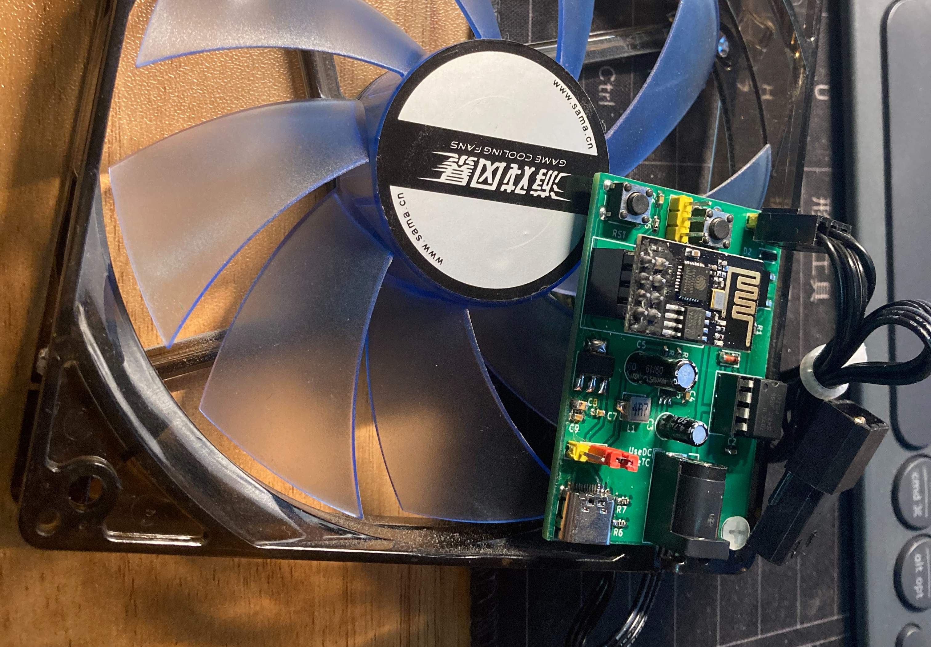

An expansion board that turns your idle fan into a smart fan that can be connected to HASS and HomeKit.
This project is drawn using KiCAD. It is recommended to download the attachment and modify it later.
Use an IO of esp8266 to output soft pwm, use ir2104 to receive this pwm and drive the mos tube to supply power and speed adjustment to the fan.
The materials used are somewhat luxurious. . You can use a transistor to drive a mos tube. The actual current of the mos tube is not large (12V power supply, no load, 0.037A, full speed, 0.210A). You can choose a mos tube with a lower rated current.
4HU54BnUa5P2Or3gDkftXGWC6iwqEFg8NVxL1QHu.jpegWmC4OzXfjgqqqszZQaz5Lzjur9PEgMW2CVCyOcIy.jpeg

Explain the following code briefly. The pwm frequency is 30k because sound will be heard at 20k and below. The low gear selects 50% duty cycle to prevent the duty cycle from being too low and the fan cannot spin. The high gear selects 90% duty cycle because 100 % can’t be transferred either (probably a problem with the mos driver)
