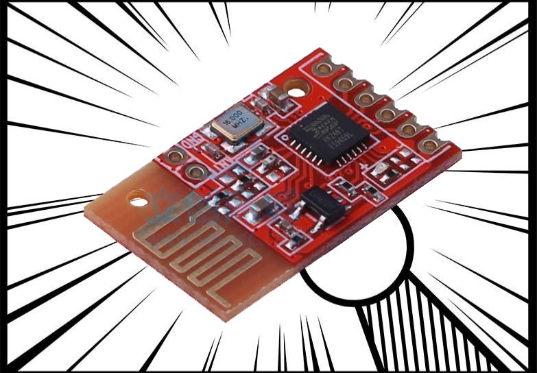

When we burn programs, we may move the development board around. Is there any way for us to enable the development board to wirelessly burn programs? (However, it eventually overturned.
Use standard TTL level UART serial port
Half-duplex communication, strong anti-interference ability
2.4GHz ISM band, no application required for use
Maximum output power 12dBm, receiving sensitivity -95dBm, transmitting working current 40mA@12dBm, receiving working current 24mA, sleep current 3.5uA
The working frequency can be set, and multiple modules are frequency division multiplexed without interfering with each other.
Communication protocol conversion and RF transceiver switching are completed automatically, without user intervention, simple and easy to use

With my efforts, the LC12S module is finally completed! Below is a tutorial to share with you.
First, connect the LC12S module to the computer and ground the SET pin (the fourth pin), as shown in the figure.
Then proceed with configuration. During the configuration process, make sure that the SET pin is reliably grounded! After entering the configuration mode, the module will use hexadecimal + 9600 bps to transmit data. It cannot be configured using other configurations. The software I use here is "Serial Port Debugging Assistant".
If the module does not return after the configuration information is sent, it may be that the configuration information is wrong, the check bit is wrong, or the connection is unstable. You need to re-create the configuration information or check the module connection!
According to the above method, we can desolder the first module for Arduino use, and solder the other module for computer sending and receiving, as shown in the picture.
Configuration completed! Now let's plug the LC12S into the computer and try the effect!
Test program.
When sending, the small light on the LC12S module lights up, indicating that the LC12S is working.
Open the serial port monitor to view the effect (19200bps)
Large rollover scene
Later I discovered that it can only run stably at 9600bps at most, and cannot run at 115200bps at all. It cannot be used to download programs remotely...
Therefore, it can only be used for communication between the development board and the computer, and between the development board and the development board. Let me share this information with everyone.
