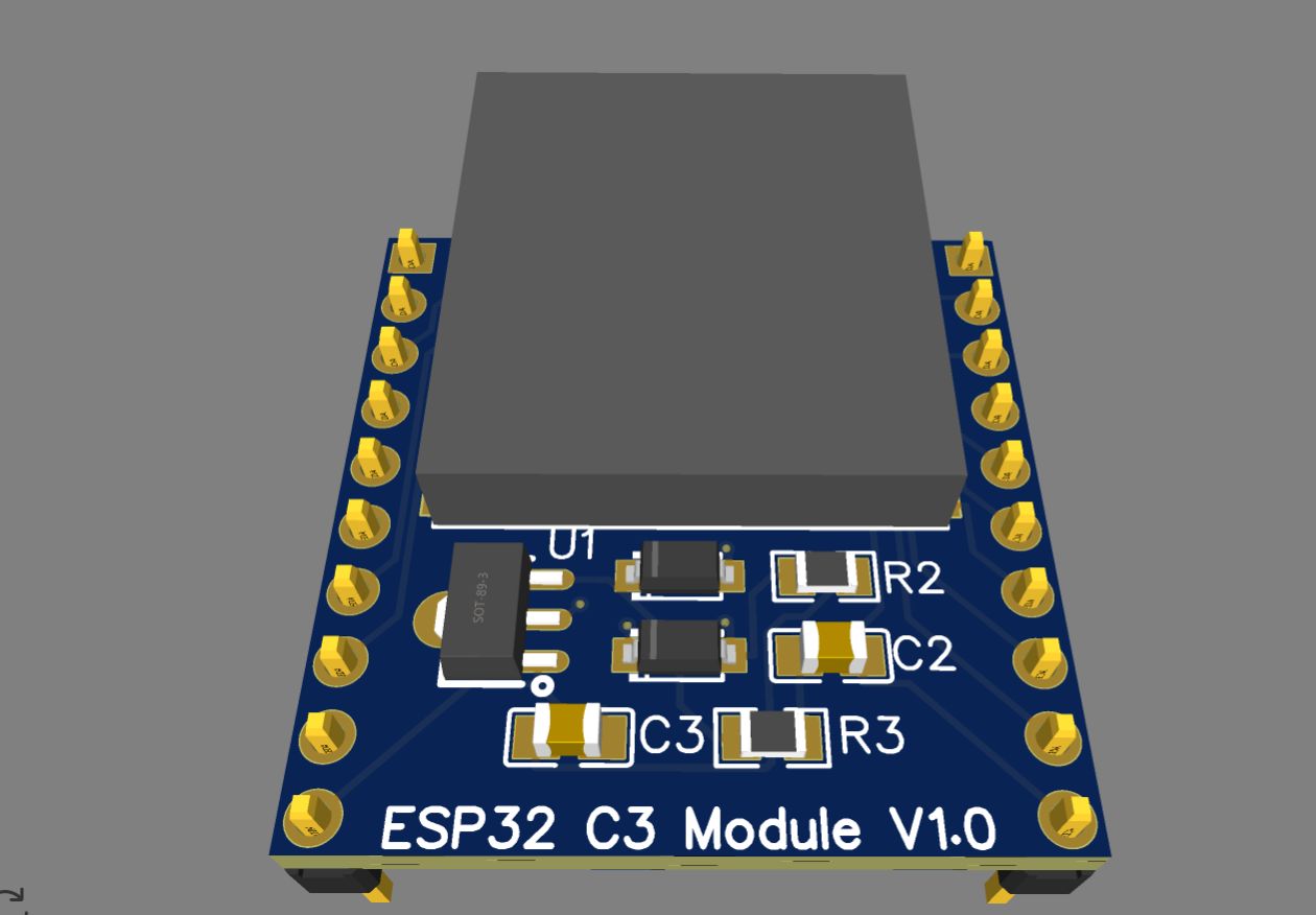

ESP32 C3 module
It can be plugged directly into the breadboard and supports 5V and 3.3V. The 5V voltage is regulated through the 1117 chip (you can choose the capacity of the tantalum capacitor by yourself, and you don’t have to connect it. If it is connected, it is best to be larger than 22uF. Pay attention to the polarity of the tantalum capacitor)
At present, the module has been laid with copper and is waiting for proofing and verification.
Things to do now: 1. Add pin definitions (already added) 2. Add download module (CH340C)
PS: This project has not yet been prototyped and verified, please use it as appropriate.
