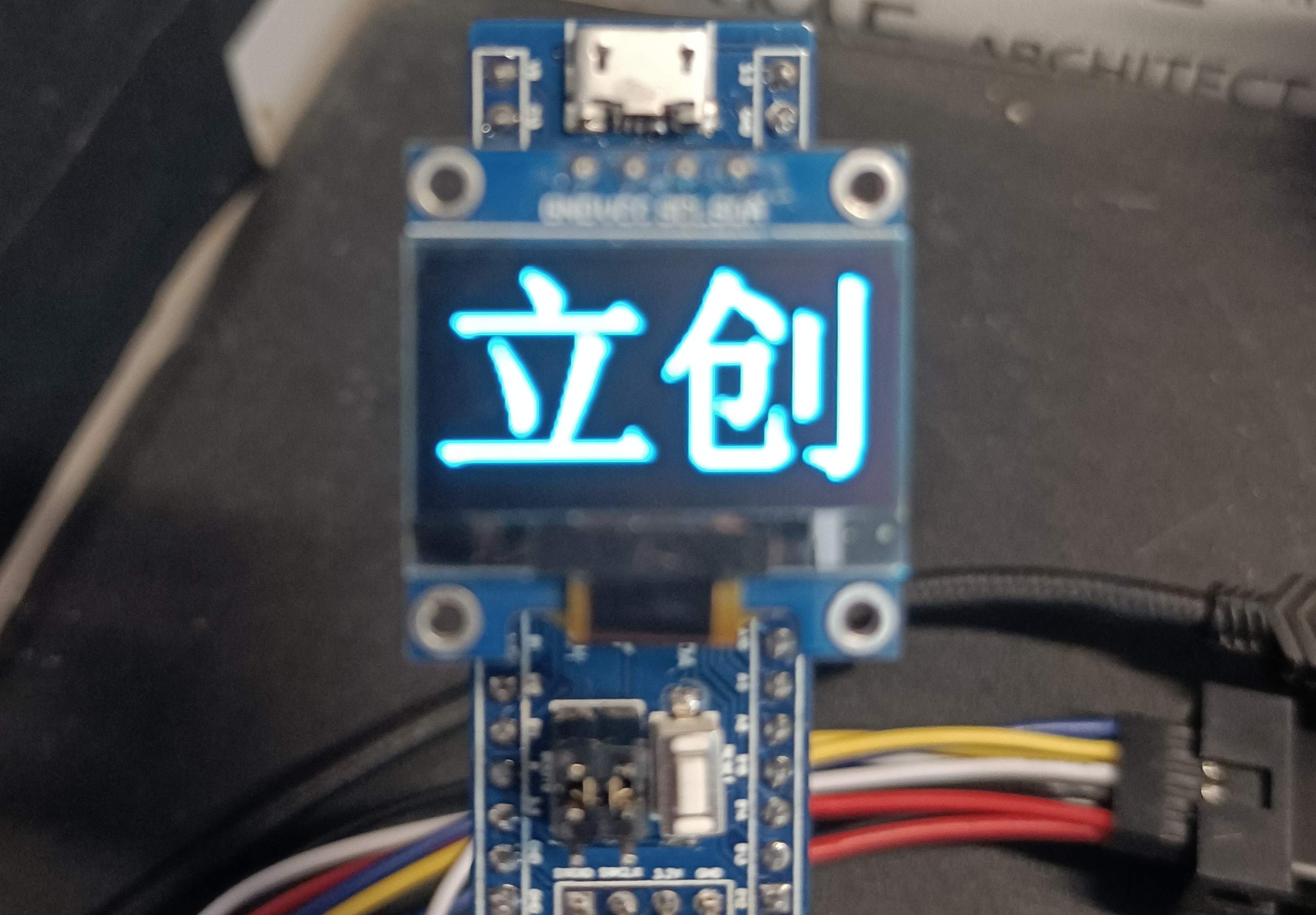

Thanks to Lichuang & Hangshun for supporting this event. . .
Thanks also to Chuangxin Workshop for providing PowerWriter (PWLINK)
The domestic core minimum system board is compatible with the STM32F103C8T6 minimum system board and can be seamlessly replaced. At the same time, a 0.96-inch OLED screen interface is added to facilitate program debugging. Flash can be added to add Chinese font library and other data packages.
During the test process, in the initial design, the LED light was connected to the SW simulation port, the PCB has been corrected, the port has been changed to PC14, and the functions have been perfected. Perfectly compatible with stm32f103cb.
It adopts 0805 package for easy welding.
The screen driver has been uploaded in the attachment. .
