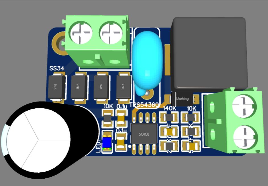

This is the most basic version of silly punch. It does not have a constant power function. The power can be changed manually by adjusting the resonance capacitor to deviate from the resonance point.
Buck chip: TPS54360;
Input voltage range: 4.5~60;
Output: 12V;
Maximum output current: 3.5A;
Note that the resonant capacitor should be a high-frequency capacitor with sufficient voltage resistance. The full-bridge rectifier diode can be selected according to its own voltage range.
The secondary board can finish the race, but it is not perfect. It can be used during testing, but it is recommended to use a constant power board in the competition.
