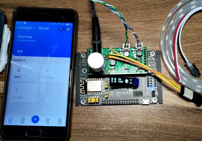

2.3 E53 interface LED driver module
Please purchase components and weld them according to the material list in the schematic diagram. The module welding is completed as shown in the figure.
Please assemble it with the development board as shown in the figure below
Precautions
  1. The board has a reserved interface for the WS2812 light strip. If you don’t have a light strip or don’t need a light strip, you don’t need to solder it.
  2. If you do not use light strips or the number of WS2812 lamp beads is less than 5, it is recommended to use a linear voltage stabilization solution; if there are more than 5, it is recommended to use a switching voltage stabilization solution.
  3. There are two PT4115 drivers on the board. If a two-color lamp is used, the left one is connected to yellow and the right one is connected to white. If you use a single-color lamp, it is recommended to only connect one channel on the right and adjust the color temperature to 6500K. The disadvantage of this method is that it wastes one drive. If you want to drive two channels of white LED, please modify the code yourself and delete the relevant content about adjusting the color temperature. .

4 使用演示
设备菜单选择配网,打开微信,在主页面下拉,搜索“腾讯连连小程序”,点击加号添加设备,在电工照明中选择灯,按照提示进行配网。详细操作步骤请看视频演示 https://www.bilibili.com/video/bv1BK411G7cn
