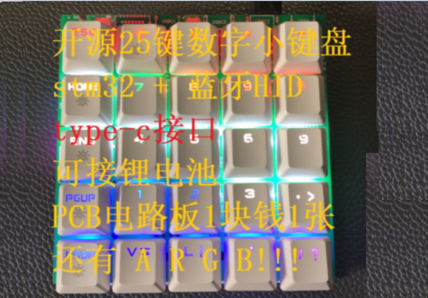

  • PCB platform: Lichuang EDA
  • Compilation environment: keil5
  • Main control chip: stm32f103c8t6/cbt6 will do
  • describe:
  • 1.stm32 master control + Bluetooth HID module 2.type-c interface can use lithium battery 3. Symphony ARGB!!!!!! 4. The function is a digital keypad that can only modify the key values ​​​​5. Low cost, do it yourself All open source programs cost only 60+ yuan each. 6. Hot-swappable (buy a hot-swappable axis seat)
  • Video introduction of Station B: https://www.bilibili.com/video/av498421712
  • The code program PCB steel plate BOM list is in the code cloud: https://gitee.com/jwdeng1995/keyboard
  • LiChuang open source platform: https://oshwhub.com/CrazySuiJi/keyboard_25
  • CSDN matching: https://blog.csdn.net/jwdeng1995/article/details/106756614
  • The size of the board is 10x10, just so that I can go to Jialichuang for 5 yuan for proofing.
