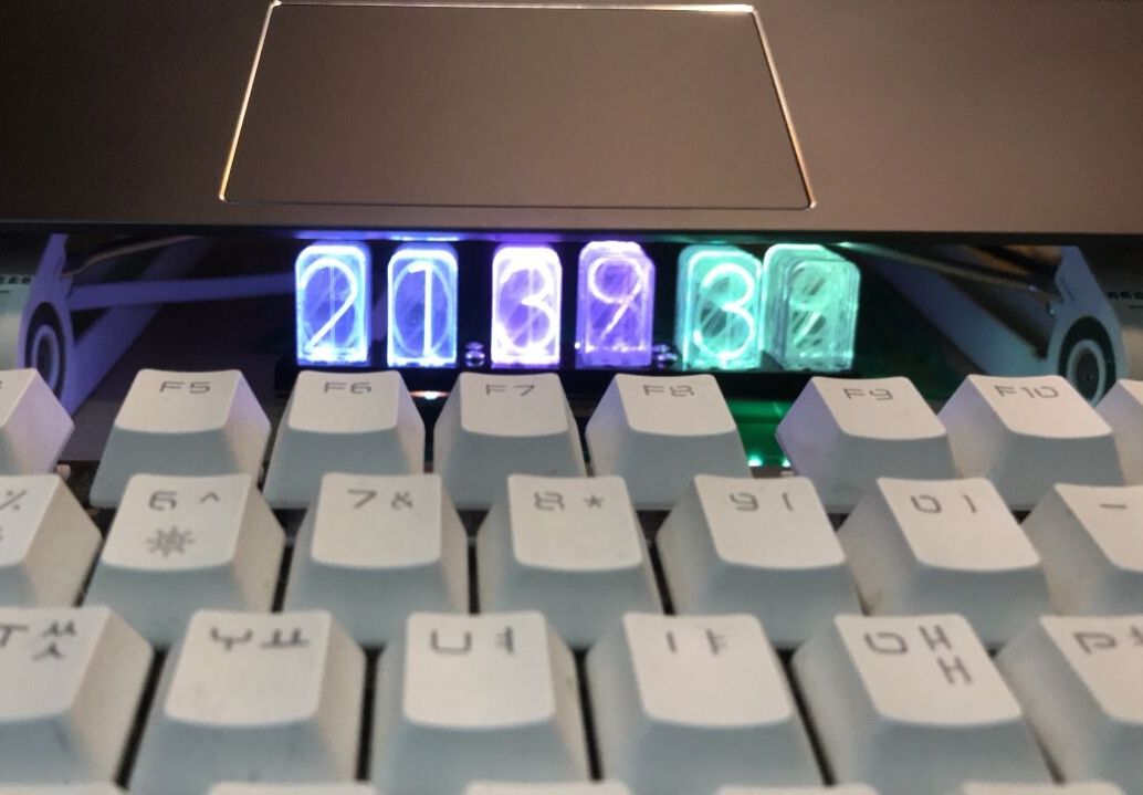

Pseudo Nixie tube mini version without copper pillar
After the program is adjusted, we will add the WeChat distribution network. Now we are still short of acrylic boards. I made proofs on the 2nd and haven’t shipped them yet on the 13th.
Special effects have been added. The water flow from 9 to 0 will stop at the end of the hour, minute and second.
The boss is missing 4 sets of digital acrylics
Acrylic proofing is so expensive.

The acrylic is scratched and it hurts. The 4 sets of numbers I bought newly have no protective stickers. They were all torn off and the numbers in the first four sets are all blurred. Only the two sets on the right are not clear.

Added schematic diagram and PCB of main control
Updated the program to adapt to PCB
ws2812 uses 0807 size
https://item.taobao.com/item.htm?spm=a1z09.2.0.0.15472e8dCA3QgO&id=625228802377&_u=627e2qqs96fb
The screws are of m2 size, and the height should be 11mm. Just double-pass is fine. It is best to buy an m2 nut. Of course, it is up to you how you choose it.
Also, the typec power supply interface on the back will hold up. If you have the ability, you can change it to the side power supply. I don’t have much time here so I won’t change it.
