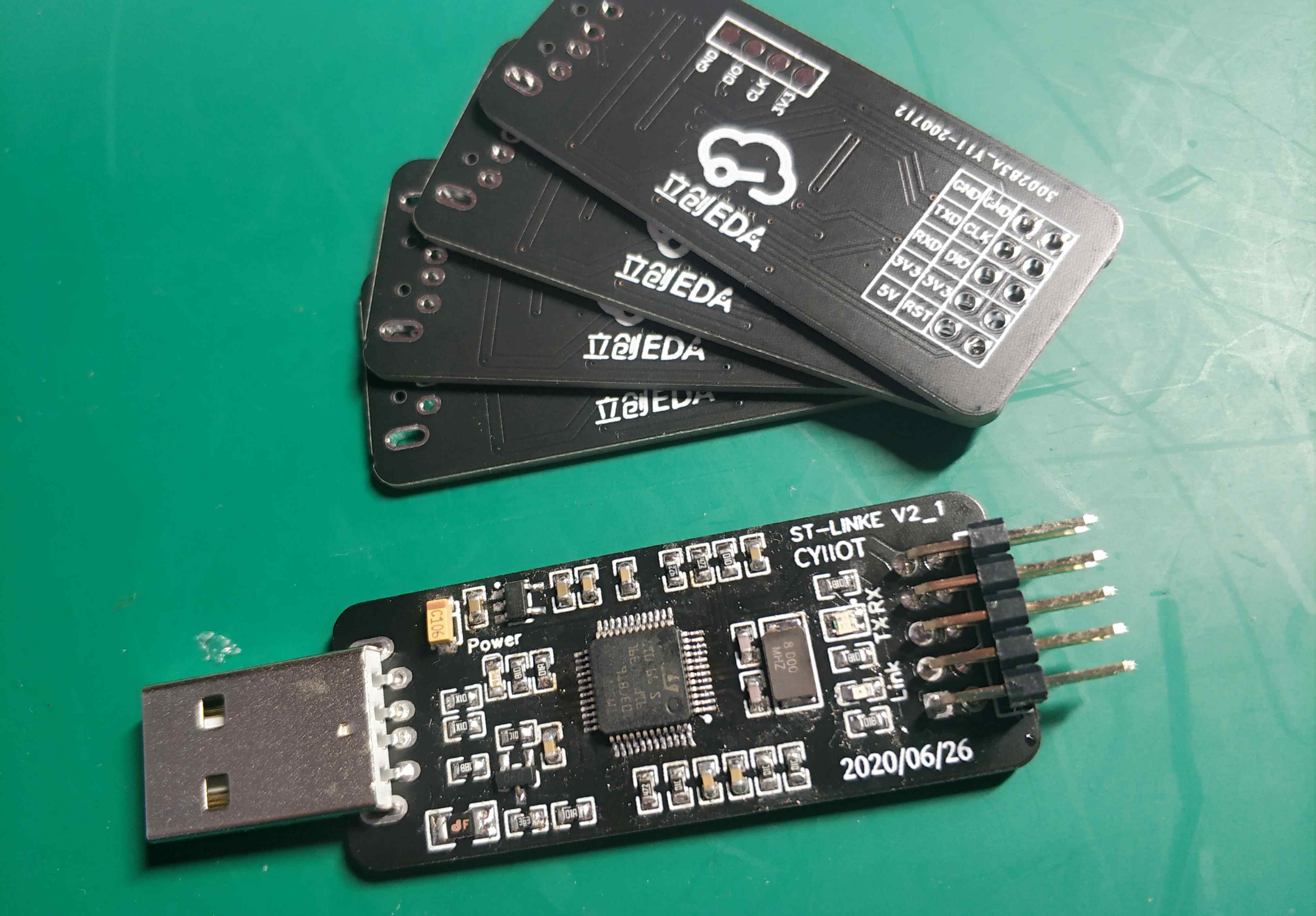

1 Introduction
  • ST-Link/V2: Supports STM32 and STM8 debugging, without virtual serial port. Most of them are sold on TB. Currently, there are several versions of ST-Link on hand. This version will be used for burning later.
  • ST-LinkV2-1: supports STM32 debugging, with virtual serial port and virtual USB disk download. This is the version of ST-Link currently loaded on ST’s official Nucleo series evaluation boards.
What this project produces is ST-Link V2-1, which is used for STM32 program downloading, simulation debugging and serial port functions.

5. PCB design
1. The D- and D+ data lines of the USB part must use differential routing .
2. The crystal oscillator circuit part must be placed close to the MCU.
6. Welding debugging

8. Verification
Display the above information and confirm that the firmware is OK
9. Test
  1. Test the burning function, use Keil-MDK, download the program successfully, indicating that the burning function is normal
  2. Test the Debug function and use Keil-MDK for debugging. If it can be debugged, it means that the Debug function is normal.
  3. To test the U disk drag and burn function, you need to generate a bin file ( bin file generation method ), drag the bin file to the U disk simulated by ST-link, and successfully burn it, indicating that the virtual U disk function is normal.
  4. Test the serial port transceiver function: Use Dupont cable to connect the TX and RX of ST-LINK V2-1, open the serial port assistant, send data, and the receiving area receives the same data, indicating that the serial port transceiver is normal
