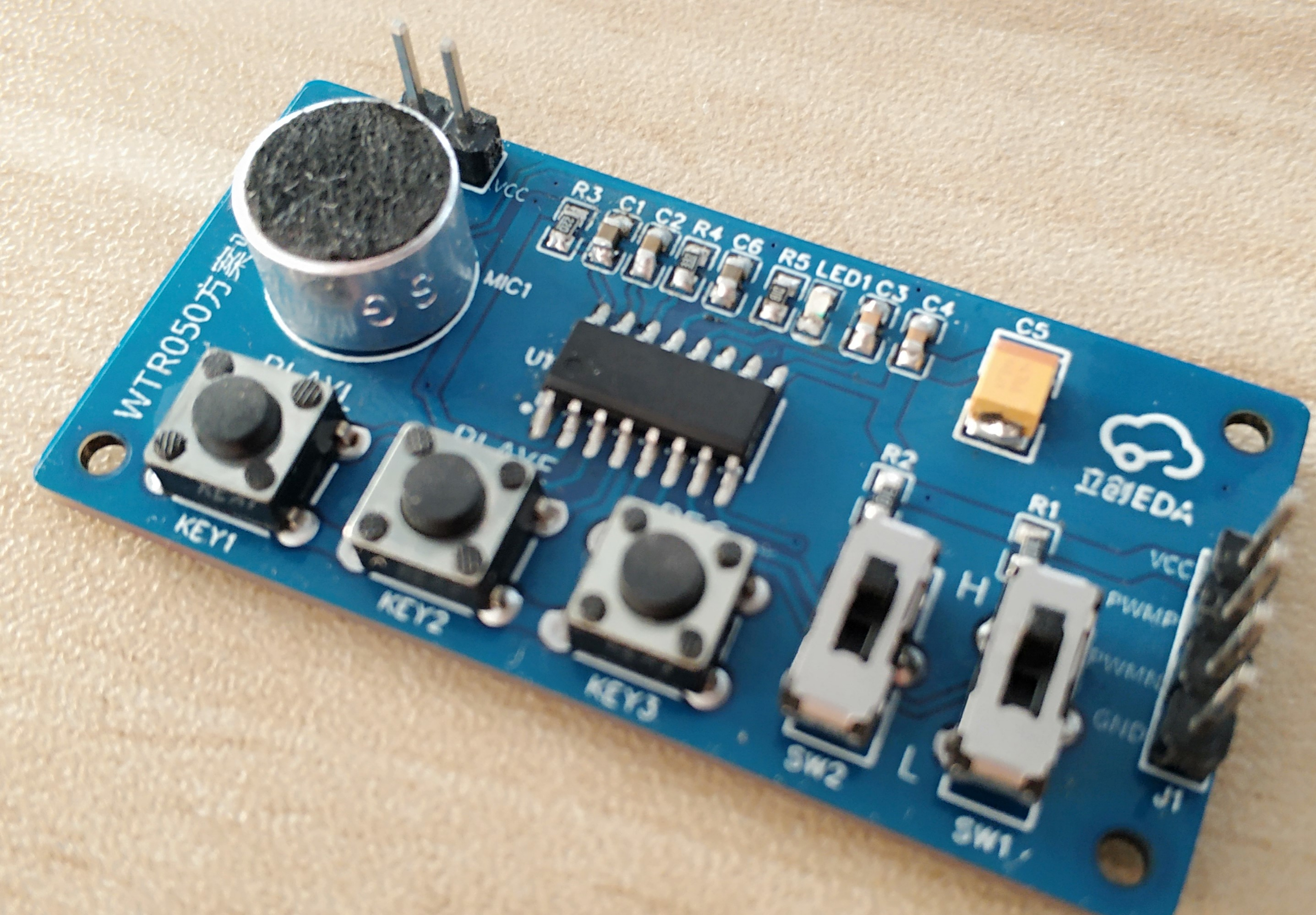

[Program verification board] WTR050 solution verification board (available for personal testing)
This project is used to verify the solution verification board design of the video and audio interface chip WTR050 of Lichuang Mall. This project is a solicitation project for Lichuang EDA open source hardware platform solution verification module.
  • This design is a recording and playback module based on WTR050, which is used to verify the basic functions of the chip.
  • WTR050 is a high-performance recording chip produced by WT (Guangzhou Weichuang Electronics) Company. It has short recording distance and good sound quality. It can directly drive the 8Ω/0.5W speaker output. The playback sound quality is clear, the volume is high, and it is easy to use.
  • The chip controls sound recording and playback through buttons, and can realize long-press recording, loop playback, short-press playback and other functions.

Module features
  • Working voltage: 2.8~5.2V;
  • Automatically enter sleep mode when not working;
  • The key functions include long press to record, short press to loop playback, long press to maintain loop playback, and long press to play;
  • The sampling frequency is 8KHz ~16KHz, and the sampling frequency can be selected by two toggle switches.
Key Function
REC: Long press to record PLAL: Long press to play, release to stop, non-loopable PLAE: Short press to loop, long press to keep looping
Sampling frequency
Sampling frequency 8KHz 12KHz 16KHz 24KHz
SW1 gear L H L H
SW2 gear L L H H
recording time 40S 25S 20S 13S
WeChat picture_20200523162808 (2).jpgWeChat picture_20200523162827 (2).jpgWeChat picture_20200523162642 (2).jpgWeChat picture_20200523162744 (2).jpgWeChat picture_20200523162801 (2).jpg
