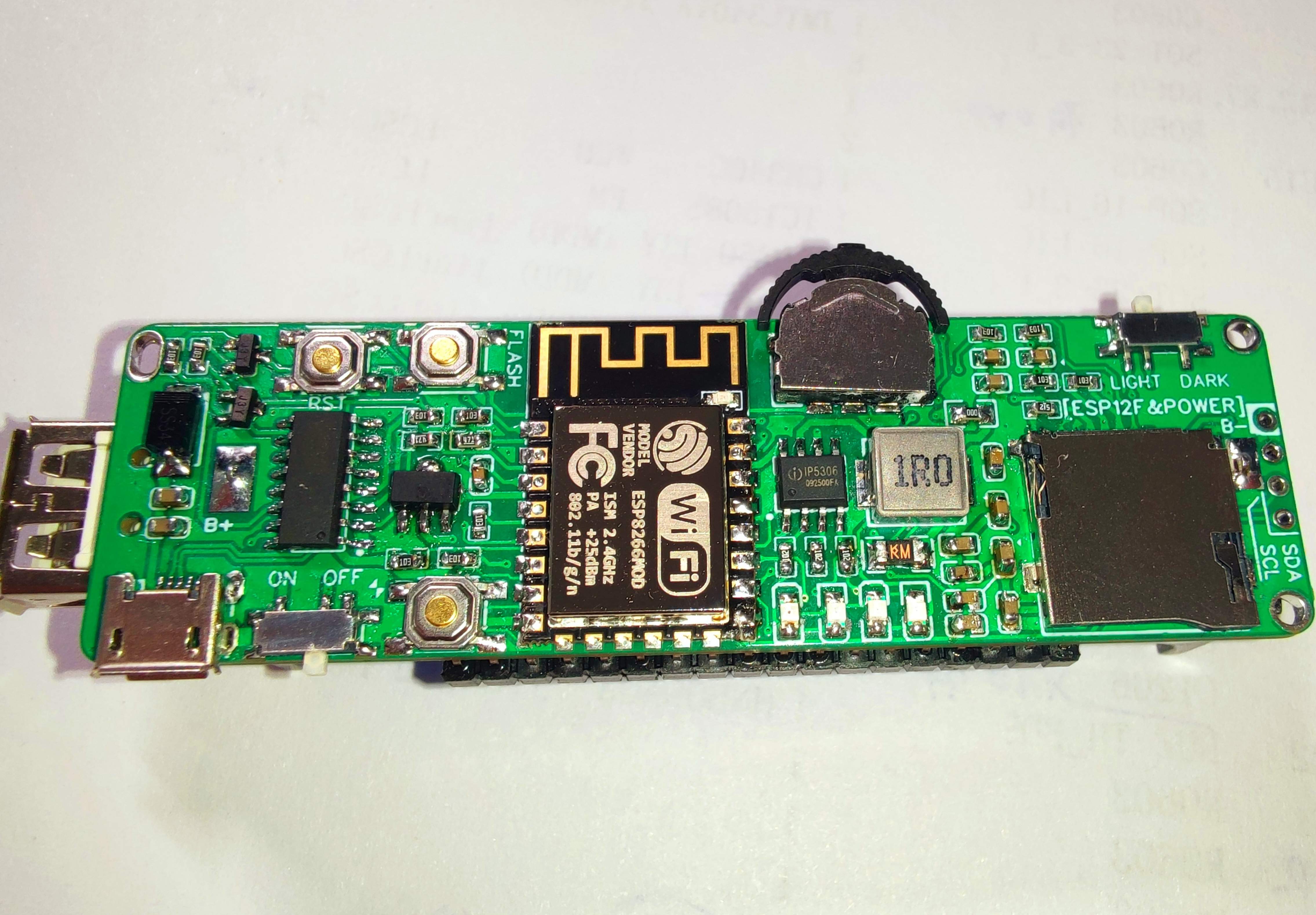

[Board verified] ESP8266-portable development board
Project Description
An ESP8266 development board with battery
Project function introduction
Function
  • esp12F module
  • CH340C+ automatic download circuit
  • IP5306 power management, charging management + emergency power bank
  • Development board full pinout
Project properties
The following projects have been completed for V0.1 and V0.2 versions, and the board can be soldered and ready to use.
  • [x] Schematic design
  • [x] PCB diagram design
  • [x] PCB proofing
  • [x] Welding test
  • [x] Functional testing
  • [x] Program testing
Circuit explanation
Things to note are all in the schematic diagram
V0.1 version 5BA22440AF8054E4C04986371D4C1973.jpg V0.2 version adds TF card + pinout + serial port expansion + power indicator light control 4B51856014D357FF75ED8C0E77FB92EC.jpg
Precautions
The usage is the same as that of Aubao's development board. Install the CH34X driver and you can use it normally. Different 18650 battery boxes have different shrapnel strengths. For some battery boxes with harder shrapnel, it is recommended to use a flat-head 18650 battery charging chip ip5306 to dig holes at the bottom to facilitate welding with a soldering iron. If a heating plate is used, consider removing the hole pad under the ip5306. What are the problems in the project? Everyone is welcome to discuss in the comment area or private message.
