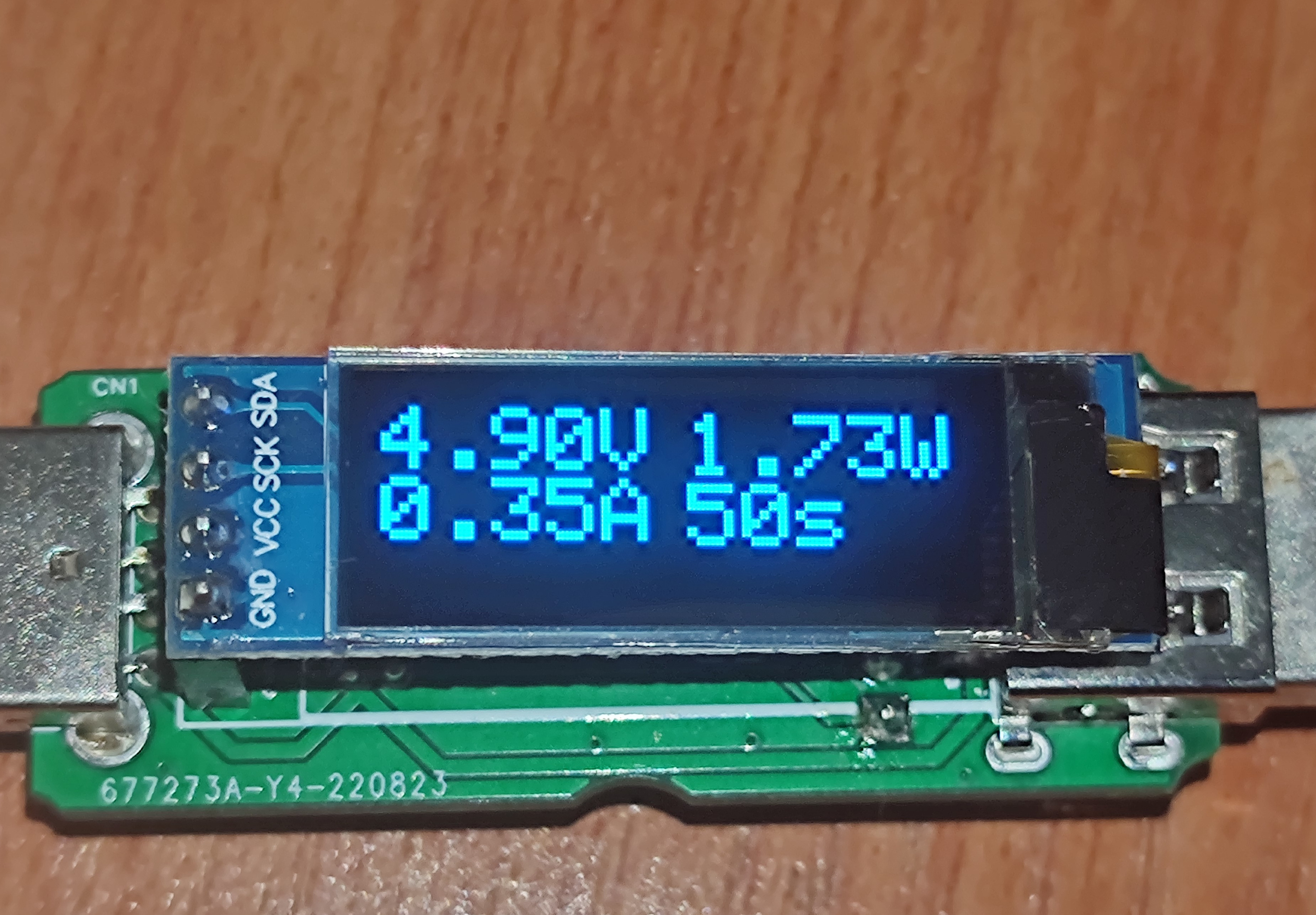

#The7thLiChuangElectricityContest#USB Ammeter
USB ammeter based on N32G430C8L7+INA199, non-fast charging version, can check the current and voltage when USB is working.
* 1. Project function introduction
No fast charging support, can only measure a maximum voltage of 6V
* 2. Project attributes
1. 0.91-inch OLED screen
2. Use low-resistance sampling resistor
3. Maximum support 6V, 2.8A
4. Display part includes current, voltage, power

*4. For the hardware part,
see the schematic diagram below, which includes nine parts: main control circuit, BOOT circuit, crystal oscillator circuit, reset circuit, voltage sampling, current sampling, voltage conversion, burning interface, OLED module. Since an internal crystal oscillator is used, the crystal oscillator circuit is not welded.
