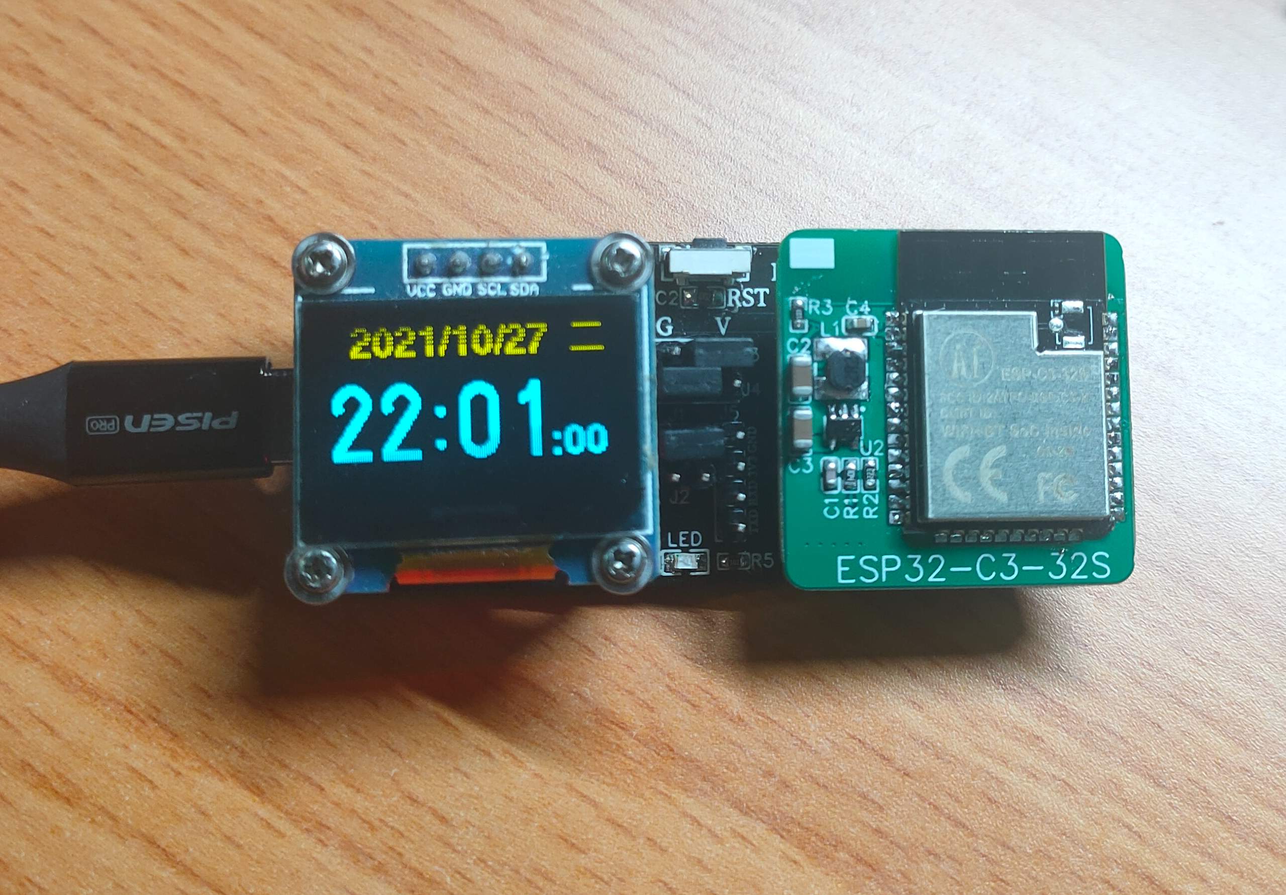

The following is a picture of the actual object:
ESP32-C3-32S core board
ESP32WROOM core board
base plate
Some of the yellow display parts are missing because my OLED is defective and those lines are broken.
