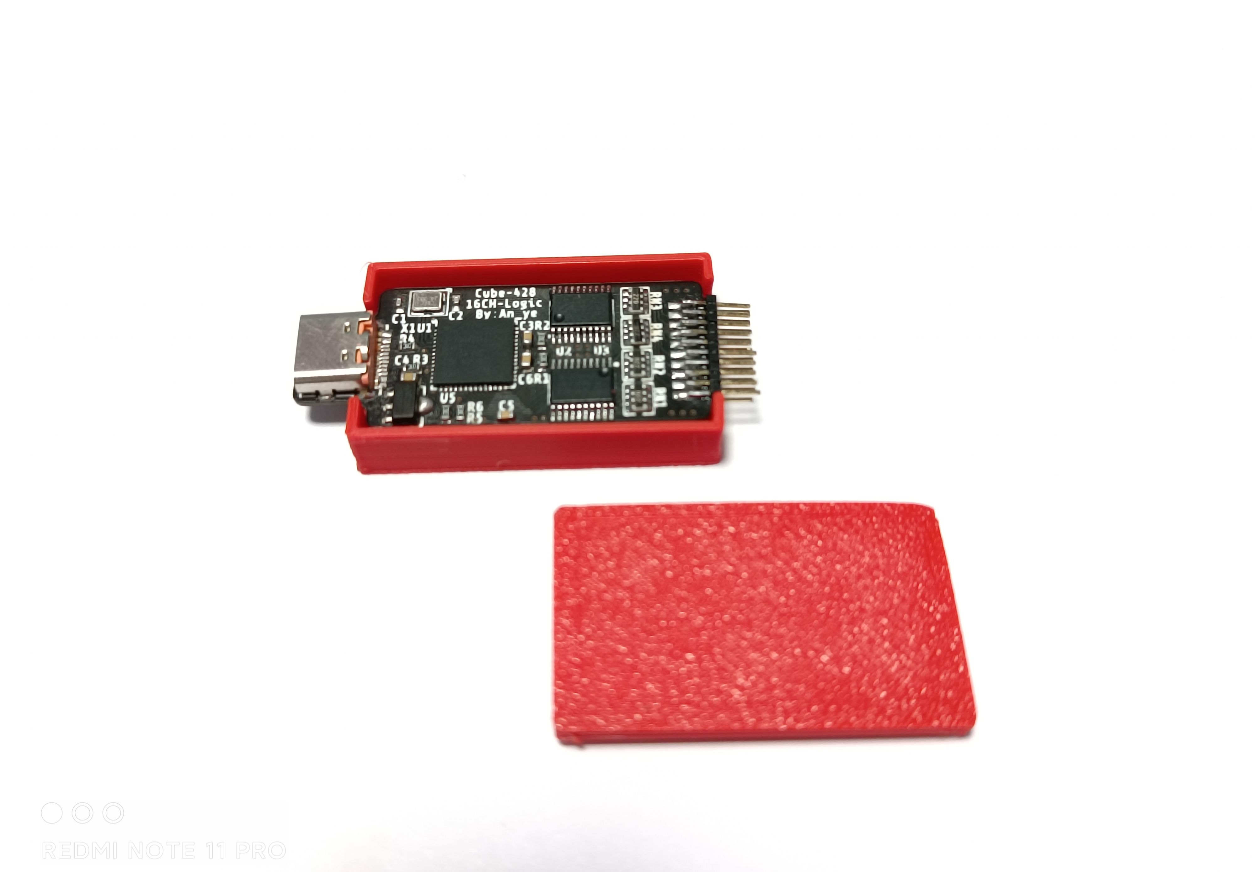

Cube-428_16CH logic analyzer
 Cube-428_16-channel logic analyzer
Ultra-small size 16-channel lolita ()
Q group 565264047 Welcome to play~
The shell file will be uploaded later. . .
Note: PCB thickness needs to be <= 0.8mm
How to eat:
0x00: Solder the board
0x01: After installing PulseView on Linux, open it
0x02: A pop-up prompts that the device failed to open. After confirmation, you need to manually select the device. First select fx2lafw, and then scan will come out.
0x03: Then you can use it
Maximum sampling frequency:
16CH@12Mhz
8CH@24Mhz
